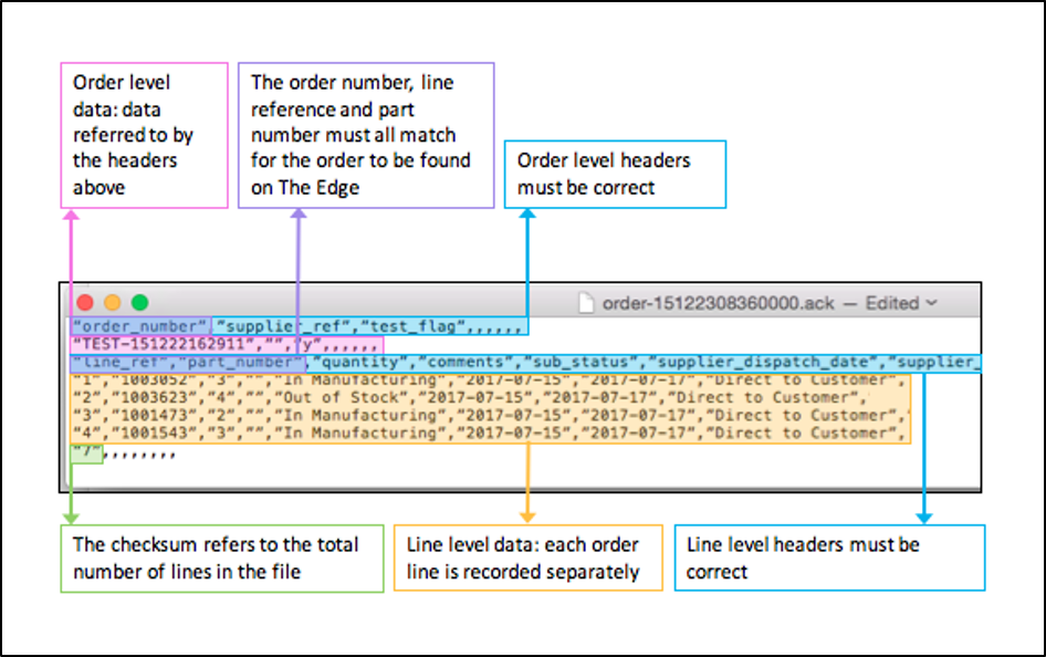

Below the standard image of example order update file setup
Note: sadly there is no example file at this point but based on the above picture and below mapping explanations I believe we can create the needed file easily
