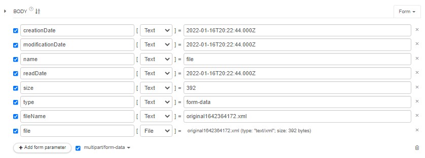

Upload File
API Call: POST https://api.ebay.com/sell/feed/v1/task/{task_id}/upload_file
API Docs: https://developer.ebay.com/api-docs/sell/feed/resources/task/methods/uploadFile
This method associates the specified file with the specified task ID and uploads the input file. After the file has been uploaded, the processing of the file begins. Note: You must use a Content-Type header with its value set to "multipart/form-data".
Example Call:
This call does not have a Request payload.
Form data
/* FormDataContentDisposition */
"creationDate" : "string",
"fileName" : "string",
"modificationDate" : "string",
"name" : "string",
"parameters" : "object",
"readDate" : "string",
"size" : "integer",
"type" : "string"
Call Mapping:
| Integration Field | Integration Notes | Integration required | Hemi Mapping | Hemi Notes |
| creationDate | No | N/A | The file creation date. Format: UTC yyyy-MM-ddThh:mm:ss.SSSZ |
For example: Created on September 8, 2019 2019-09-08T00:00:00.000Z |
| fileName | Yes | N/A | The name of the file including its extension (for example, xml or csv) to be uploaded. | |
| modificationDate | No | N/A | he file modified date. Format: UTC yyyy-MM-ddThh:mm:ss.SSSZ |
For example: Created on September 9, 2019 2019-09-09T00:00:00.000Z |
| name | Yes | N/A | A content identifier. The only presently supported name is file. |
| parameters | No | N/A | The parameters you want associated with the file. | |
| readDate | No | N/A | The date you read the file. Format: UTC yyyy-MM-ddThh:mm:ss.SSSZ |
For example: Created on September 10, 2019 2019-09-10T00:00:00.000Z |
| size | No | N/A | The size of the file. | |
| type | Yes | N/A | The file type. The only presently supported type is form-data. |
| file | Yes | N/A | The actual file |
Example Response:
A successful call returns an HTTP status code of 200 OK. This method has no response payload.
