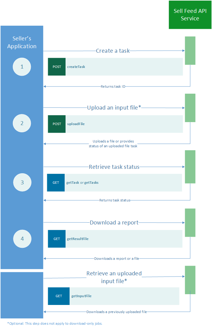

Feed API upload flows
This section provides links to the associated LMS call and the Feed API call for specific upload flows. See the What's Changed section following each table for additional information about migrating to the Feed API from LMS.

- The taskId is used in the uploadfile call.
Upload Input File
| LMS | Feed API |
| uploadFile | uploadFile |
What's Changed:
- In LMS, the seller can either attach file as input or place its base64 encoded value in the request body. File input can only be a zipped xml formatted file for uploadJob.
- For the Feeds API, the input can be an xml file and zipped or in regular format (both formats are allowed). The input can be a file or InputStream type (Inputstream can be used while uploading file programmatically).
- Use the Feed API getInputFile method to download the file previously uploaded usinguploadFile.
Start Upload Job
| LMS | Feed API |
| startUploadJob | Not applicable for the Feed API |
- In the Feed API, the task is automatically moved to Queued Status, waiting for processing and will be picked up by the system.
- The QUEUED status in the Feed API corresponds to the SCHEDULED state in LMS.
