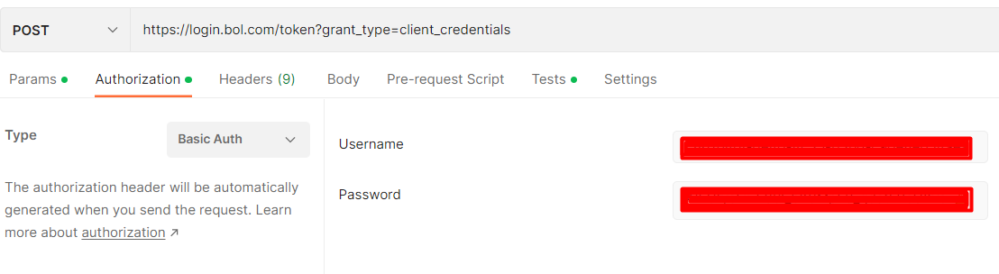

Authorization
The base URL for all your API connections is https://api.bol.com/retailer.
Bol use Basic OAuth authentication and based on username and password we can generate an access token which expires in 299 seconds.
For the credentials please contact Bogomil PavlovAPI Call: POST https://login.bol.com/token?grant_type=client_credentialsRequest Parameters: grant_type=client_credentials
<v1.2>Mapping:
| Bol Field | Hemi Field | Comment |
| Username | Account Bol > Username | Basic Auth |
| Password | Account Bol > Password | Basic Auth |
We want to store the credentials in Account Bol.**</v1.2>**Sample Request:
Sample Response:
200
"access_token": "eyJraWQiOiJyc2EzIiwiYWxnIjoiUlMyNTYifQ.eyJzdWIiOiJjODYxYjRkZi1kZTQwLTRjMzUtYjNiZC1jOTBlOGUwNTRhZWEiLCIyZmEtZW5hYmxlZCI6ZmFsc2UsImF6cCI6ImM4NjFiNGRmLWRlNDAtNGMzNS1iM2JkLWM5MGU4ZTA1NGFlYSIsImNsaWVudG5hbWUiOiJIZW1pc3BoZXJlIiwiaXNzIjoiaHR0cHM6XC9cL2xvZ2luLmJvbC5jb20iLCJzY29wZXMiOiJSRVRBSUxFUiIsImV4cCI6MTY4MzcxMTgyMCwiaWF0IjoxNjgzNzExNTIwLCJhaWQiOiJDTE5UQzpiZTJiNzAxNi03MzQ2LWMzNmUtZDEzOC03NzcwODE3M2Y3YmMgU0xSOjE1NjYxODIiLCIyZmEiOmZhbHNlLCJqdGkiOiJhYTJhMzhkZC04NmQwLTRjOGUtYjU1Zi1hNWMyODE0YzZjN2IifQ.Mxp90l970sAmuyyzopby2CZwDx9Qlh2KunbELc9dejjf34KVCkE6ULGEFhAoQNct_3ra0IEZmsItqrj29gvCpPev-XW0pa-1EwNn3OGJ5GF0u57hfpHkSpukrJzpH-LVtFppDfFRoKpdalDE-h1V7IGIq7EpFLCzVCOoMNIxElhfIxxLiJyMk28ghSk-9BNH0lbnRoELHoAlJhwLSO0db_V-EXMP__j9Gq2UPZeLxYNJYBse7KiNId-OTggF5_QlU4ZkXWu0BqJQUwVrAVQR1_xDe_qVGGnzZOHZzYb5Bgbt6nu_vCJmAT_QyXYoDDt_PvgLX6BDSOUolKp5qlN3uQ",
"token_type": "Bearer",
"expires_in": 299,
"scope": "RETAILER"
Please note it is up to the dev team if we shall store the access token in the cache or in the database.
