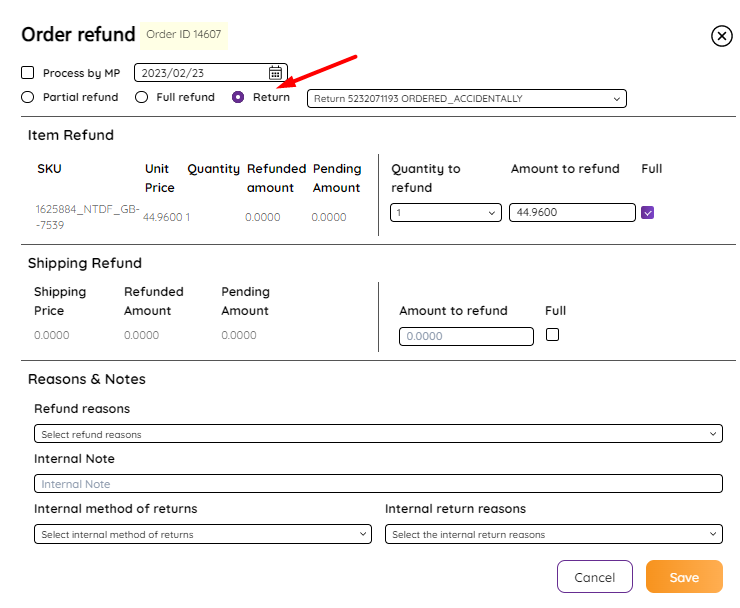

(v1.2)In order to refund the return we should use the refund UI and be able to select the Return Id from the dropdown field when the type is “Return“
(v1.2)This will create the refund for the return and after successful response we need to process and update all relevant fields as described Refunds send general logicIf we receive an error we want to store it in Order Errors table with the relevant error message and set Order Claim > Status = Error and also the Order Payment > Status = Error
