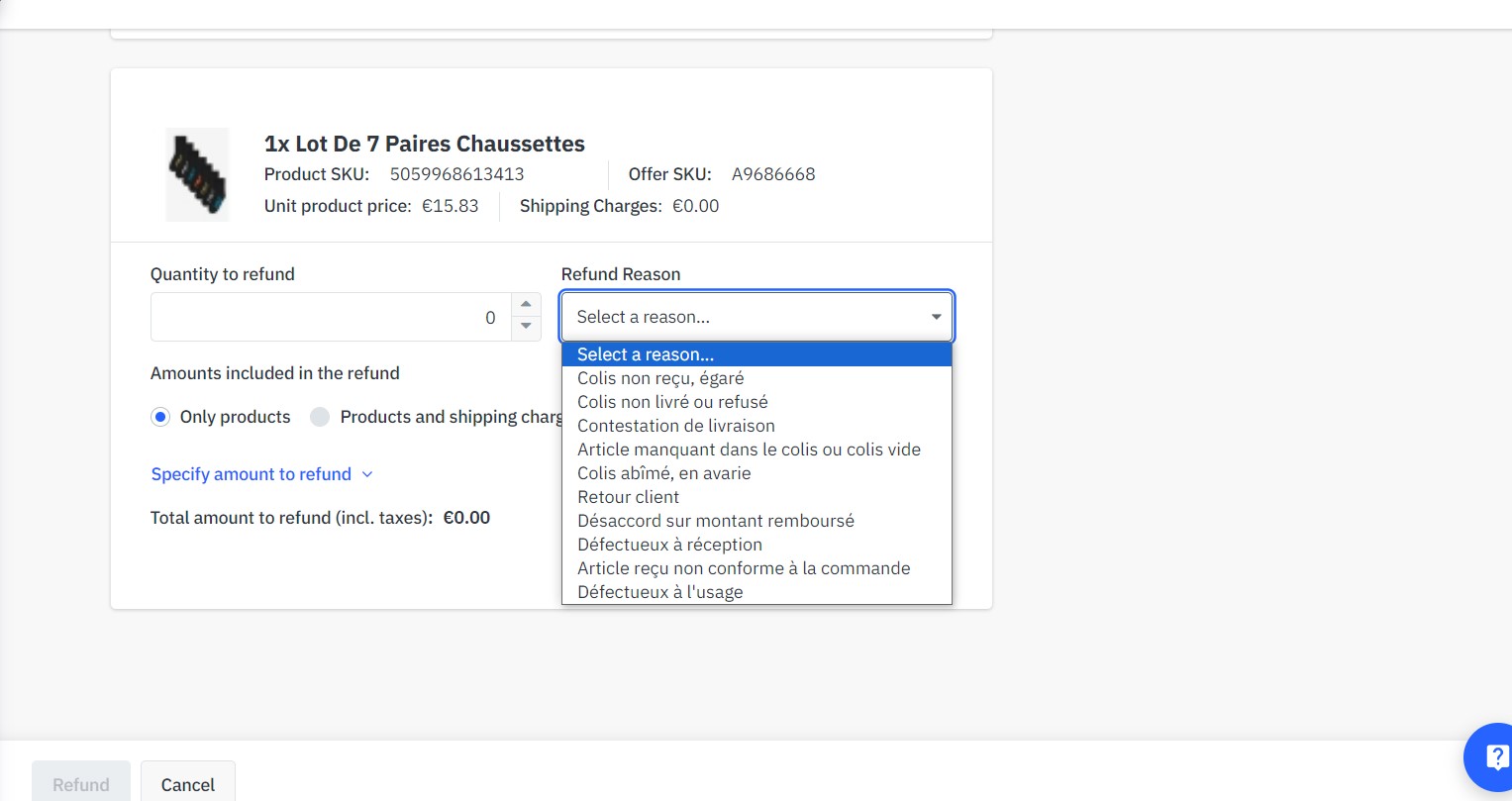

GET RE01 - List reasons
API Call:/api/reasons
API Docs: https://laredoutestg-stg.mirakl.net/help/api-doc/seller/mmp.html#RE01
Please note we need to store only the reasons which are with type = “REFUND“ and type = “CANCELATION“. <v1.4> We also only need to store refunds which are with label written in French as NO other refund reasons will be accepted. Screenshot below :

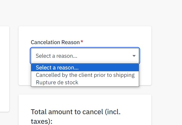

Bear in mind we need to display the label into the UI but to send the code.
Because in our UI we cannot distinguish the refund from the cancellation we need to add in the label what type is the reason is for the refund or for cancellation.
E.G. [REFUND] - {label} or [CANCELATION] - {label}

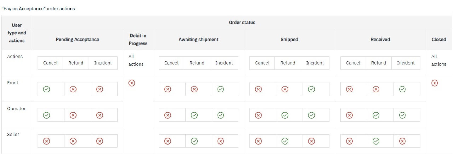

<v1.7> How to decide when to make a cancellation or refund is stated on the order.
Since LaRedoute will be going with "pay on acceptance" workflow this will mean that as soon as we accept the order it will be marked as debited and it will become only refundable (can_cancel will be false and can_refund will be true). This will practically mean that we will be using only one call to make refunds, regardless if it is pre-shipment or post-shipment. This will be the OR28 call.
We don’t need any validations as practically we will have only the OR28 call to use for refunds. If we for some reason receive an error for whatever reason, we want to store it in the Order Errors table with type Refund Send
Please check the table below for better understanding.
</v1.7>
