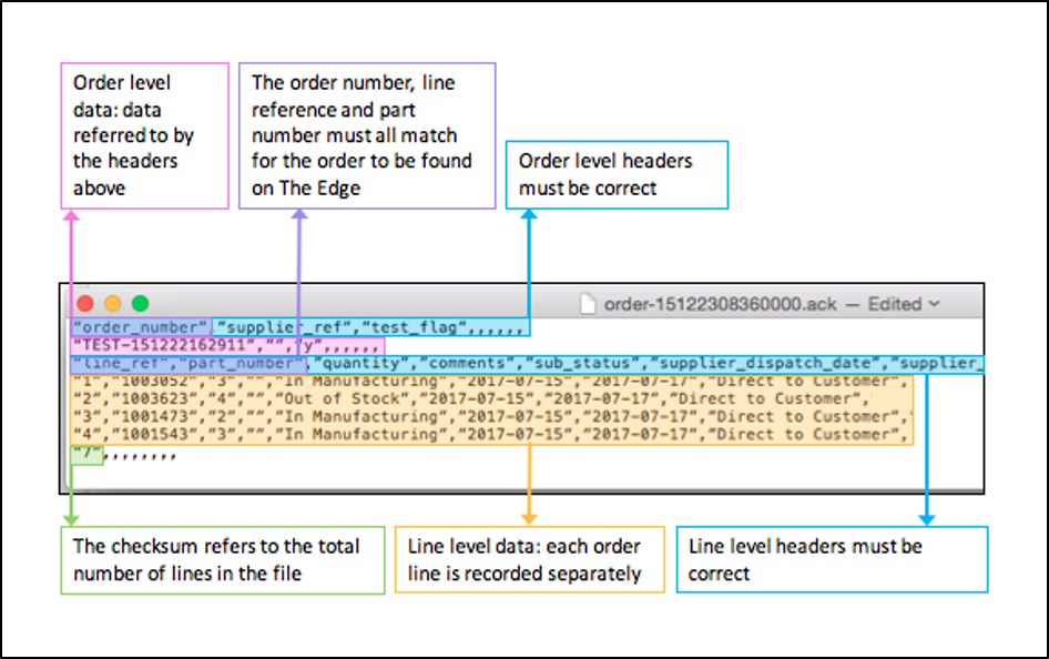

Below the standard image of example order update file setup
Note: sadly there is no example file at this point but based on the above picture and below mapping explanations I believe we can create the needed file easily

Filename format: cancel-yyyymmddhhmmssnnnnnn.ack
Sample file:
Example Mapping: Please note there are two mapping sections below for better differentiation between the main order section and the ordered items section
