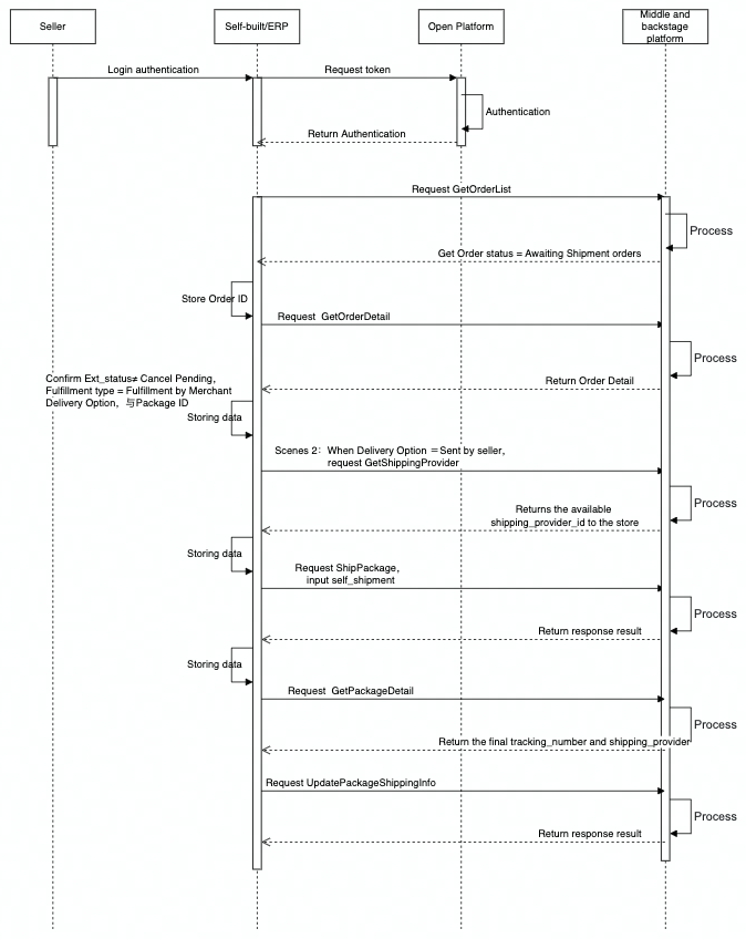

The purpose of this page is to give good understanding of the TikTok’s shippment logic.
To ship order on TikTok, first we should get & store all the available couriers for TikTok because is mandatory when shipping an order to push shipping_provider_id. We are not able to ship with provider which is not part of the TikTok shipping provider list!
TikTok ship orders, using package_ids. Each order has assigned one package_id, which need to be used for shipping.
As we will not integrate to “Split/Combine package“ API at this stage, we are able to ship the complete order (not support partial shipment!).
To ship the order we should have payment record for the order, order status to be on “Ready For Shipping“ & Shipment = Pending (waiting for information to be sent to the MP)
The shipment process is straight forward - we need to push the package_id, which we have received in “Get Order Details“ response, the shipping provider identifier (we get & store all available shipping providers, using “Get Shipping Provider“ API call) & tracking number.

  • Ship Package
To ship an order (package) we should have Shipment = Pending
In order to ship the package, we should push the package_id (which is received into Get Order Details response and stored in Order TikTok > Package ID) and the shipping provider ID we are going to ship with. The shipping provided id will be taken from the TikTok Couriers table; ;
At this stage, we will not integrate to “Split/Combine Packages“ API, and we need to make sure we are not able to ship partially on TikTok and we should ship the complete order (with all products in the order)
When we send shipping request and If chosen courier is deleted from TikTok list, and we try to ship with this courier, we will have an error in Order Shipment (Error message: The courier you want to ship with is not part of TikTok couriers anymore.) and we will not send shipping request for this order
If there are no preselected carriers into the table TikTok couriers, the error message will appear (Shipment Error, which error will describe there are no carriers selected)
Detailed explanation with example:
We get the courier name from Order Shipment > Courier OR Order > Shipping Carrier (this is the priority). And once we get the courier name, we have two paths to get the TT shipping provider ID.
First check: First we need to check in (Hemi) Couriers table (1513) for a match against the Courier > Name field. If we have a match, we check if there is a value in the mapping table (TikTok Couriers Mapping) in order to reach to the right TikTok Courier > Shipping Provider ID. If there is no match or no value in the mapping table, we go to the second check.
Second check: Here we will check directly in TikTok Couriers (20501) table for the chosen courier. The check here is done against the Shipping Provider Name column.
If there is no match on check 1 and check 2, we send shipping provider ID which is not part of TikTok list, there should be an error message, which need to indicate we should choose a courier from TikTok list (example error: You cannot ship with a courier which is not from TikTok list)

In order to ship the package, we should push the package_id, which will be stored into Order TikTok > Package ID;
As we are not integrating to “Split/Combine Package“ APIs, we need to ship the complete order(not supporting partial shipment). If we try to ship partially, we will have Order Shipment on Error and there should be an error message(Partially Shipment is not supported) returned and stored into “ Order Error“ table.
Note: We are not able to ship order with status “Partially Shipped”.
We will use the validations, described in abstraction here: https://wearepentagon.atlassian.net/wiki/spaces/HEMI/pages/2075820405/Order+management+general+requirements#Ship
