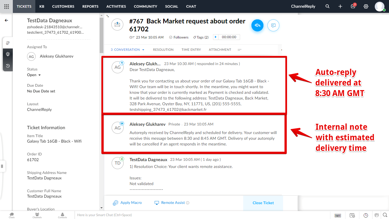

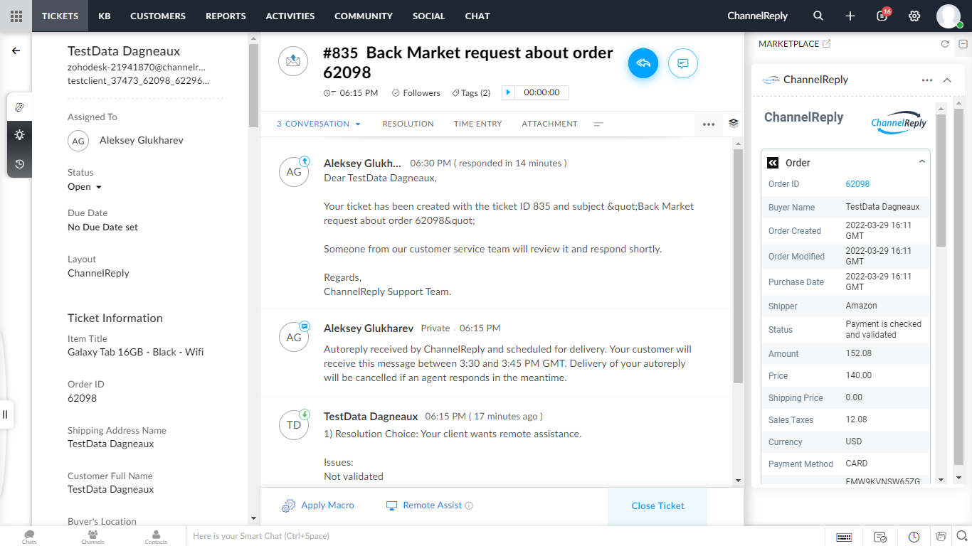

This autoresponder system generates messages once every half-hour. When a reply is triggered, you will instantly see an internal note in Zoho Desk estimating when the message will be sent.
Internal note from ChannelReply with estimated autoresponder delay
Note that the delay could be up to 35 minutes. Once the wait is over, your auto-reply will appear inside the ticket. The message will then be delivered to the customer instantly on Amazon, eBay, Shopify or Walmart tickets. (Back Market tickets have an additional delay of up to 5 minutes after the message appears in Zoho.)
You can safely answer your messages at any time. If an agent responds to a ticket before the auto-reply appears in Zoho Desk, ChannelReply cancels the auto-reply. The agent's message is delivered immediately, and the customer will only see the human response.

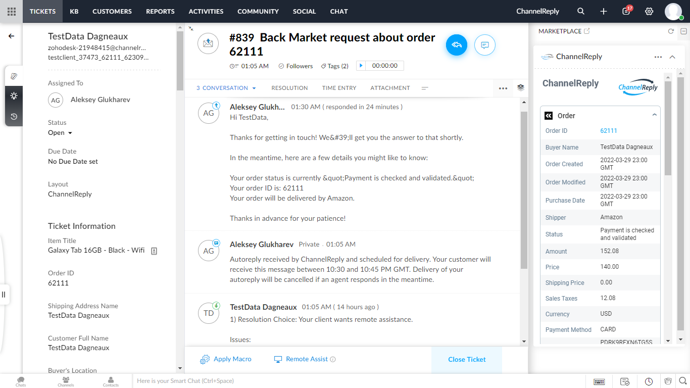

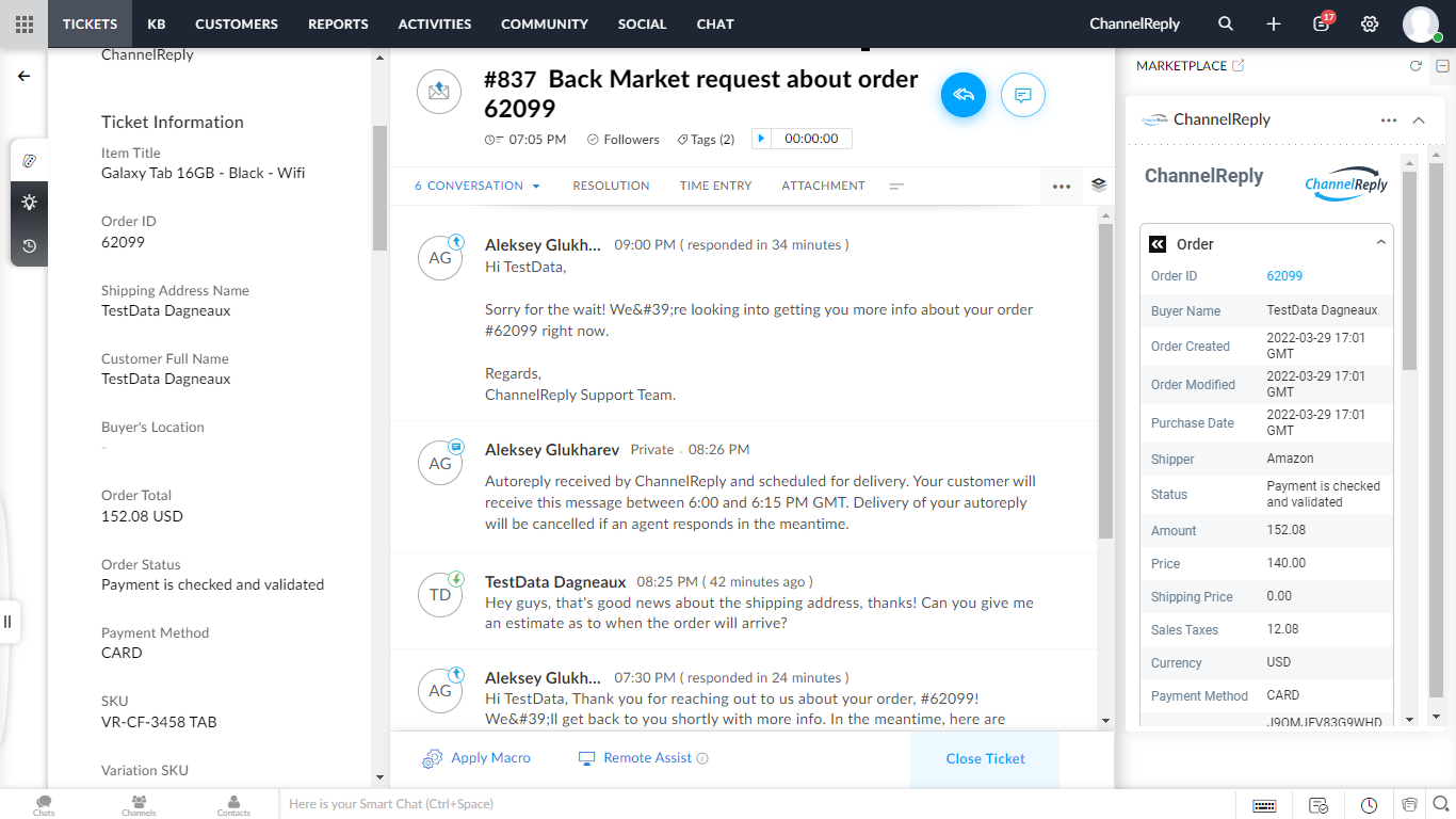

Differences Between What You and the Customer See

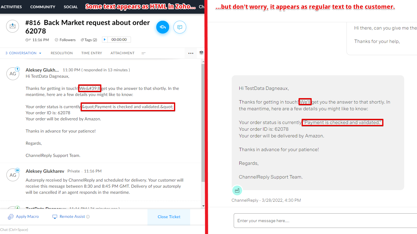

The message shown in your internal note may display common symbols like quotation marks as HTML code. Have no fear—this is normal! Your message will be delivered to the customer with the actual symbols displayed properly.
HTML code appearing in an autoreply in Zoho Desk but appearing as regular text when delivered to the customer

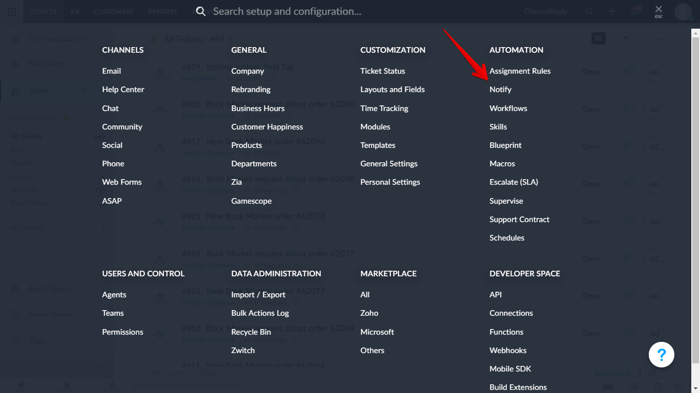

QS 1. Go to Notification Rules

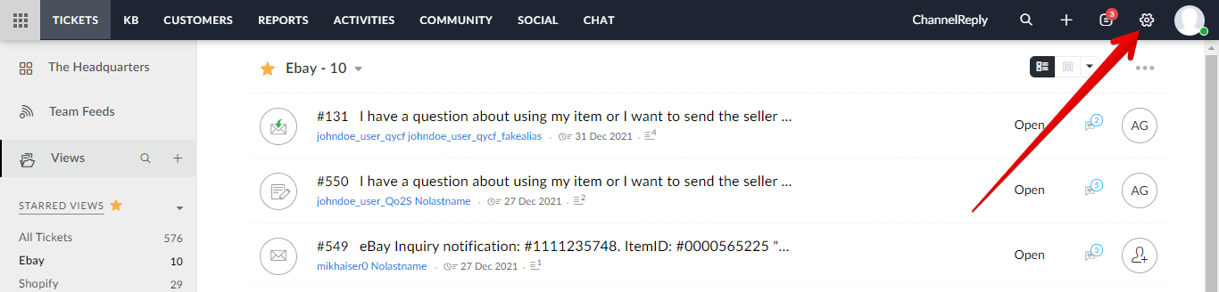

In Zoho Desk, click Setup (the gear icon in the upper right).
Setup button in Zoho Desk (the gear icon in the upper right)
Choose “Notify” under “AUTOMATION.”
Notify under Automation in Zoho Desk Setup

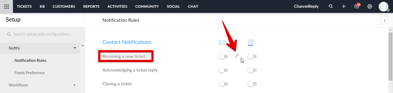

QS 2. Edit “Receiving a New Ticket”
Find “Receiving a new ticket” and place your cursor next to the Email Template slider. The Edit button (a pencil icon) will appear. Click this now.
Edit button for the Receiving a New Ticket notification rule appearing when moused over

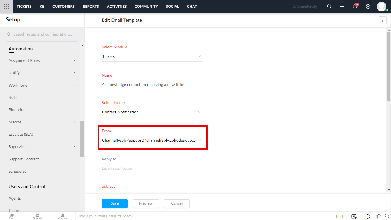

QS 3. Set Your “From” Address
Make sure you have an email selected in the “From” address dropdown.
From field with an email address selected
Note that marketplace customers generally will not see the address shown here. However, customers who contact your Zoho Desk account directly will see it.

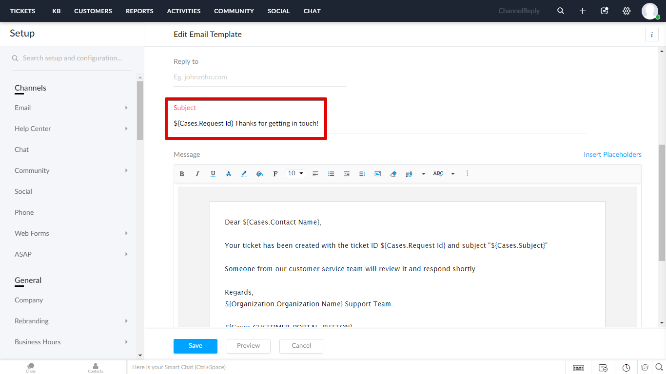

QS 4. Start Your Subject Line with ${Cases.Request Id}
It's unlikely that any of your marketplace customers will ever see your autoresponder’s subject line. It won’t appear in messaging systems like Seller Central. Plus, most marketplaces will overwrite your subject line when they email customers about your message.
But with the wrong subject line, the autoresponder won’t work at all.
Zoho Desk’s default subject line for “Receiving a new ticket” is as follows: [##${Cases.Request Id}##] Your ticket has been created
This default subject line will not work with ChannelReply’s autoresponder system. Your subject line must begin exactly as shown below:
${Cases.Request Id}
This placeholder will show the Zoho Desk ticket number for this conversation. While it generally won’t appear in marketplace replies, it will be visible to customers who contact your Zoho Desk account directly.
You must include a space between this placeholder and the first word of your actual subject line. So, the following would be acceptable:
${Cases.Request Id} Your ticket has been created
However, we recommend writing a custom subject line to make your message less likely to be flagged by spam filters.
Subject line starting with ${Cases.Request Id}

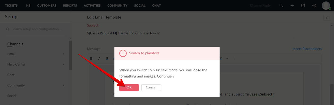

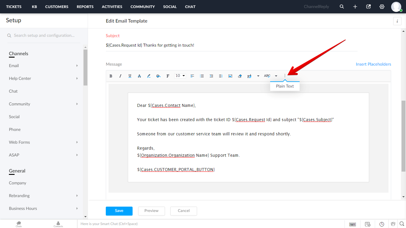

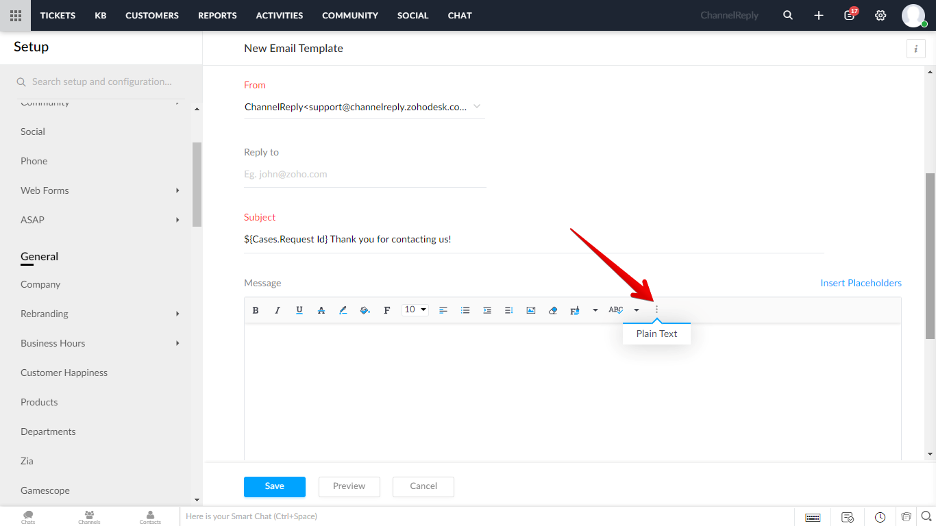

QS 5. Switch to Plain Text
Zoho Desk’s message fields are set to rich text by default. While this gives you more formatting options, it can also result in formatting errors, like unwanted line breaks. And since most marketplaces will remove some or all rich text formatting anyway, it’s best to use plain text.
To switch to plain text, click “More” (the column of three dots on the far right of your formatting options). Then hit “Plain Text.”
How to switch from rich text to plain text in Zoho Desk
Click “OK” in the popover that appears to confirm your decision.
OK button on the switch to plain text confirmation popover

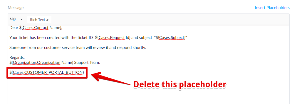

QS 6. Delete ${Cases.CUSTOMER_PORTAL_BUTTON}
Your message can be just about anything you want. The only critical change to make is to delete this placeholder from the message: ${Cases.CUSTOMER_PORTAL_BUTTON}
${Cases.CUSTOMER_PORTAL_BUTTON} placeholder, which should be deleted
This placeholder creates a link to the ticket in Zoho Desk. Since most marketplaces have rules against links leading anywhere off their site, it’s critical to get rid of this.

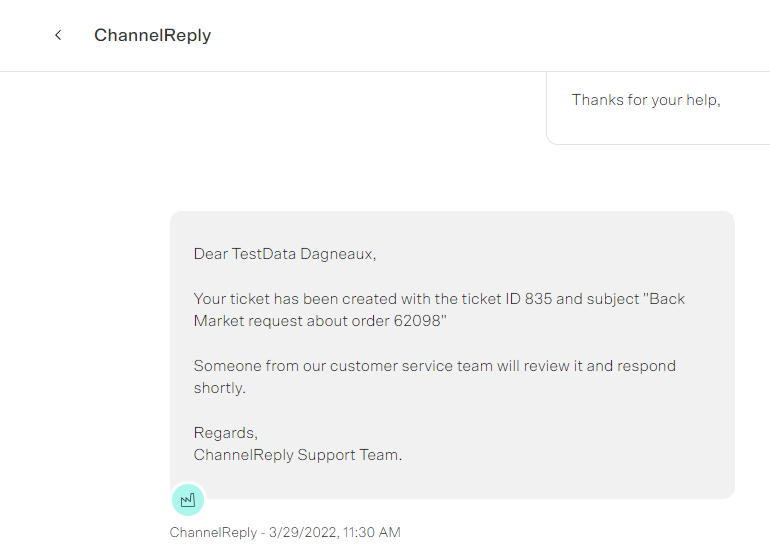

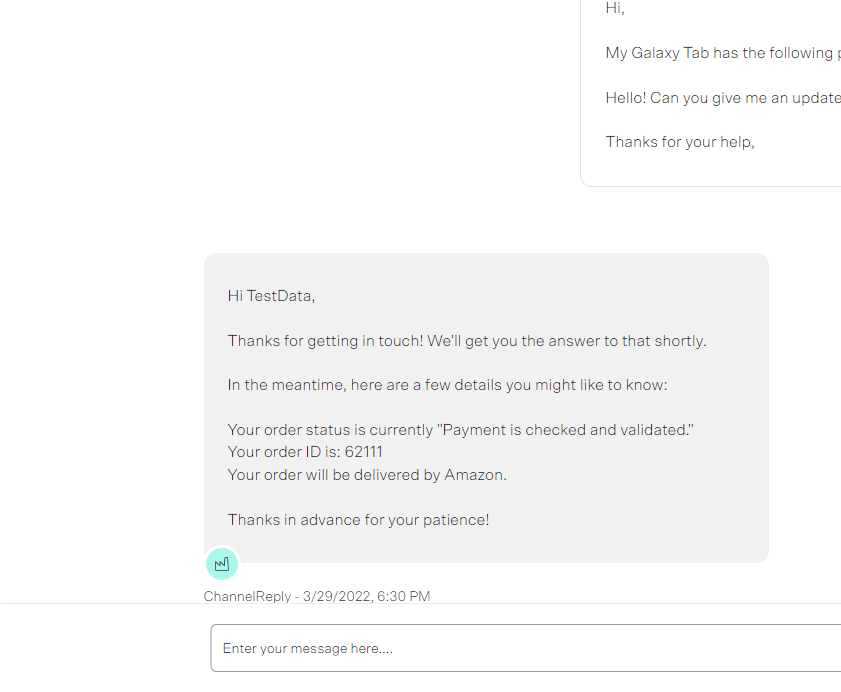

Zoho Desk autoreply to a Back Market message with default placheholders populated
Above: What you would see in Zoho Desk. Below: What the customer would see in their marketplace messages.
Autoreply with default placeholders inside Back Market

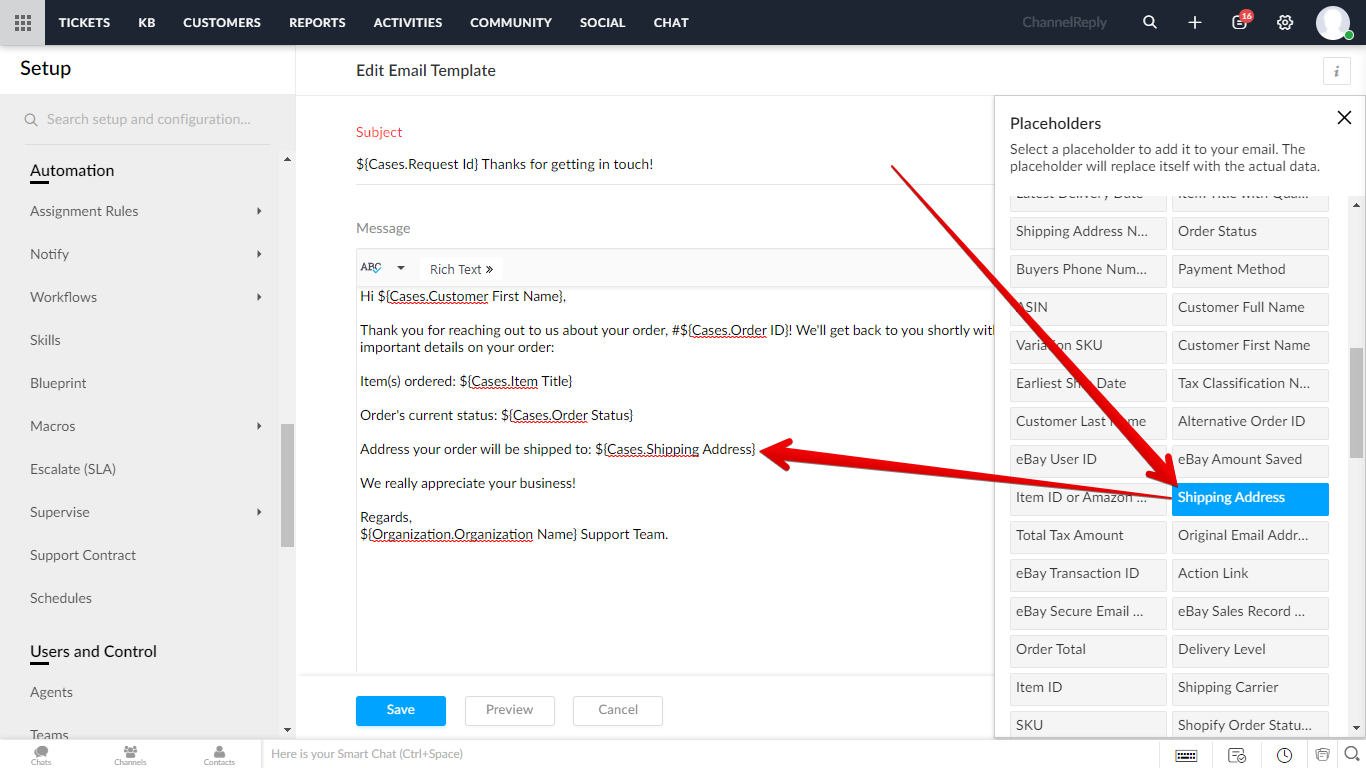

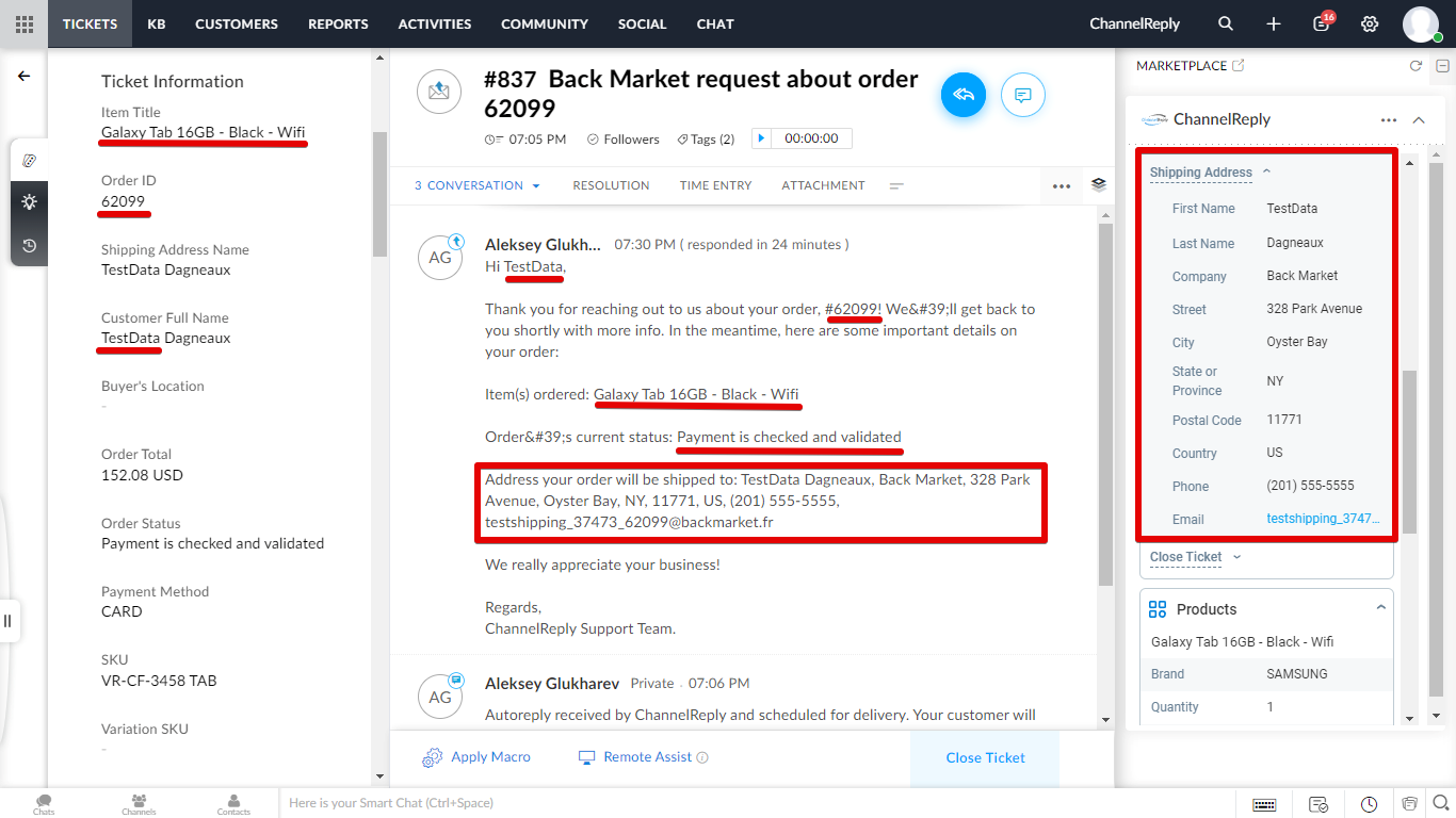

It can be even better to use our custom fields. These let you personalize your autoreply with details about the customer’s order.
Entering ChannelReply custom fields like Shipping Address in a Zoho autoresponder message

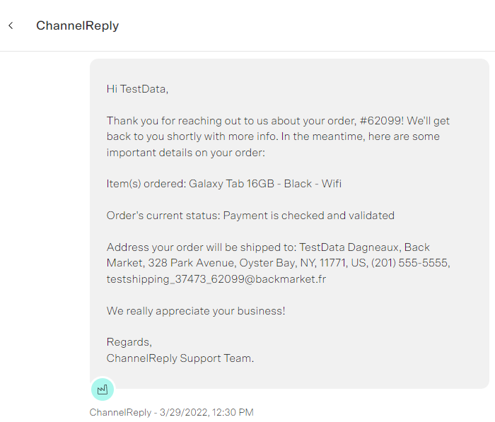

Zoho auto-reply with customer first name, order ID, item title, order status, and shipping address placeholders populated
Zoho Desk auto-reply with ChannelReply placeholders in Back Market

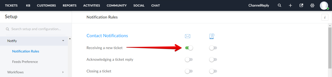

QS 8. Save and Enable the “Receiving a New Ticket” Rule
When you’re happy with your message, click “Save.”
Save button on the Receiving a New Ticket notification rule
You’ll be returned to the list of notification rules. Enable “Receiving a new ticket” by clicking the slider in the Email Notifications column. (When the knob is on the right and the slider is green, it’s enabled.)
Receiving a New Ticket enabled with the slider turned green
Your autoreply is all set! Now, every time a new ticket is created, your auto-response will be delivered to the customer.

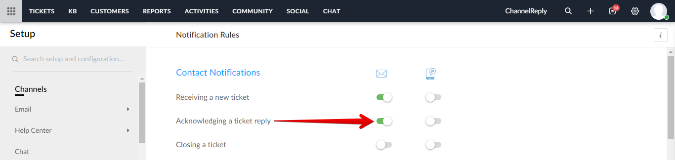

QS 9. Optional: Edit “Acknowledging a Ticket Reply”
If you want to auto-reply to every message in a ticket, not just the first one, you’ll need to set up a second notification rule. Edit “Acknowledging a ticket reply.”
Edit button appearing for Acknowledging a Ticket Reply when moused over
The settings for this follow-up auto-reply are exactly the same as for the first autoresponder rule. Go back to step 3 above and follow all steps through step 7. Just make sure to write a different subject line and message than you used in the first rule.
Acknowledging a Ticket Reply configured to work as a ChannelReply autoresponder for Zoho Desk
Once you’re finished, save your rule and you’ll be returned to the Notification Rules page. Click the “Acknowledging a ticket reply” slider to enable it. Once the slider is green and the knob is on the right, you’re all set!
Acknowledging a Ticket Reply enabled
Your customers will now receive auto-replies after every message.

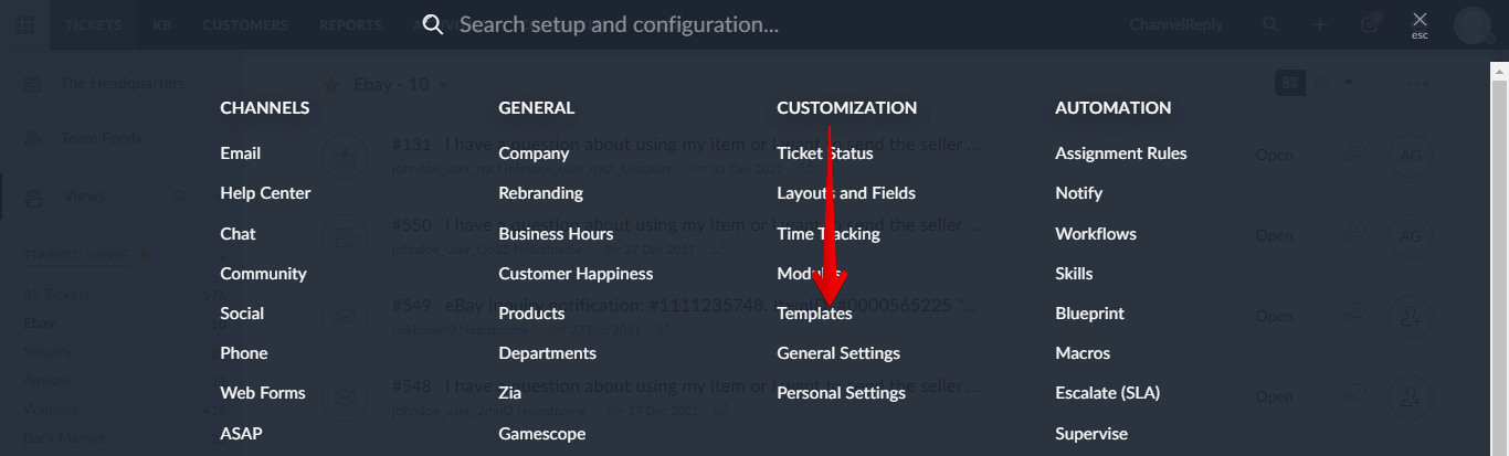

To create a template, click “Setup” (the gear icon in the upper-right of your Zoho Desk screen).
Under “CUSTOMIZATION,” click “Templates.”
Templates under Customization in Zoho Desk Setup

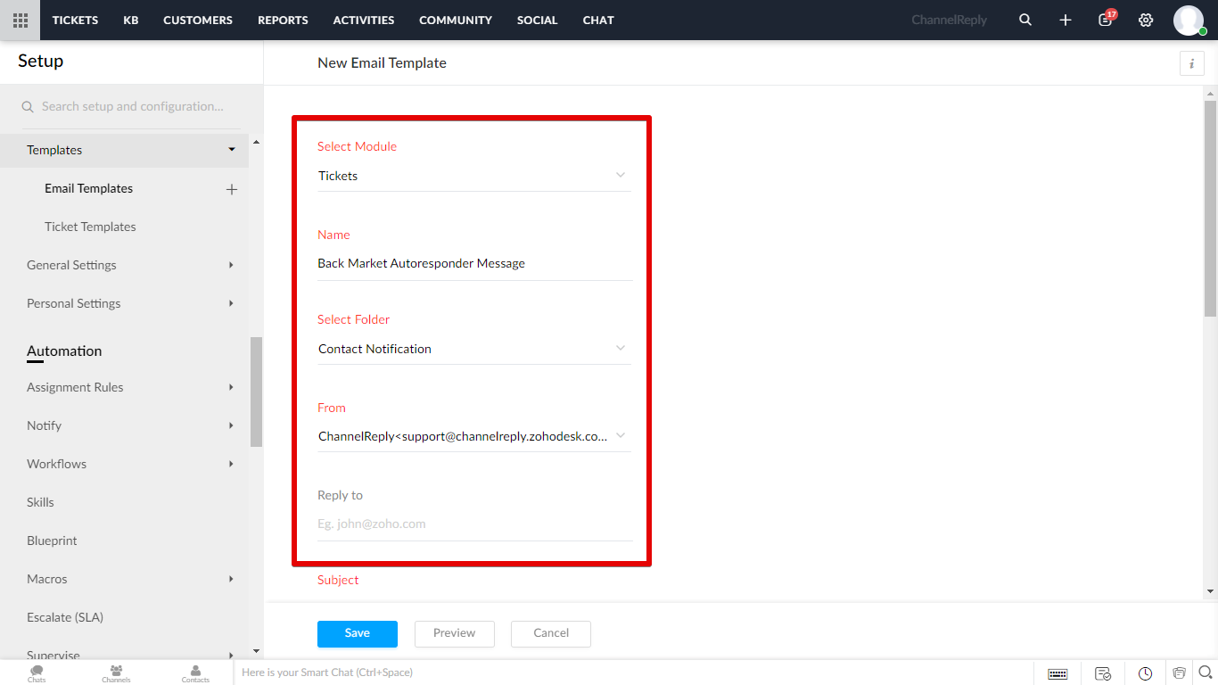

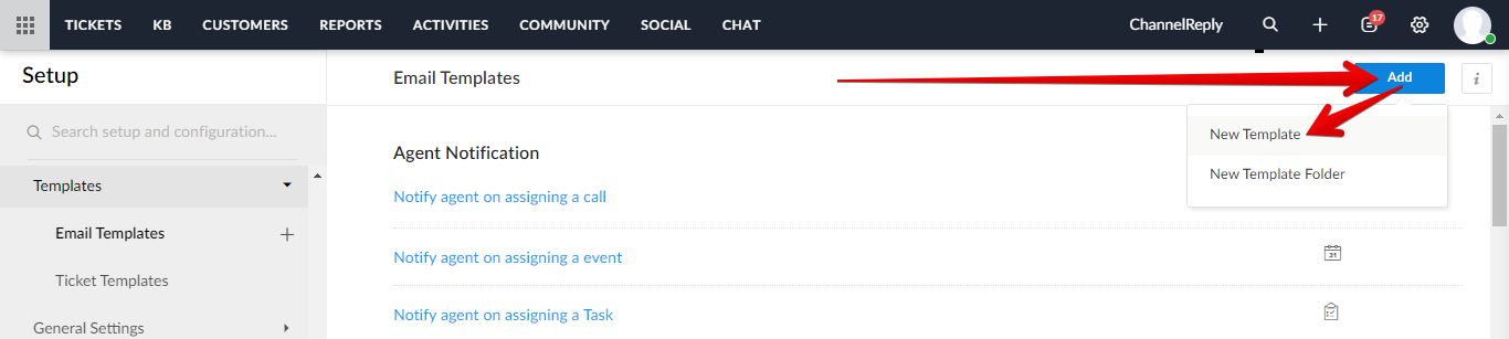

Click “Add” > “New Template.”
Add button and New Template option
Leave the module set to “Tickets.” The folder and “Reply to” field can generally be left unchanged as well. Just make sure the “Name” and “From” fields are filled in.
Select Module set to Tickets, name entered, folder set to Contact Notification, From field filled in, and Reply To field empty

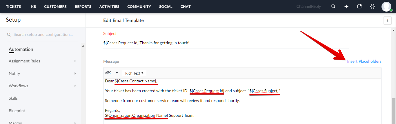

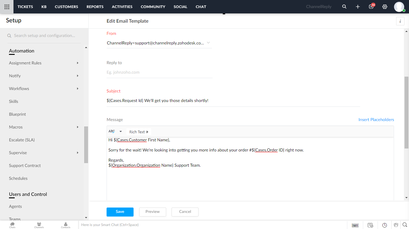

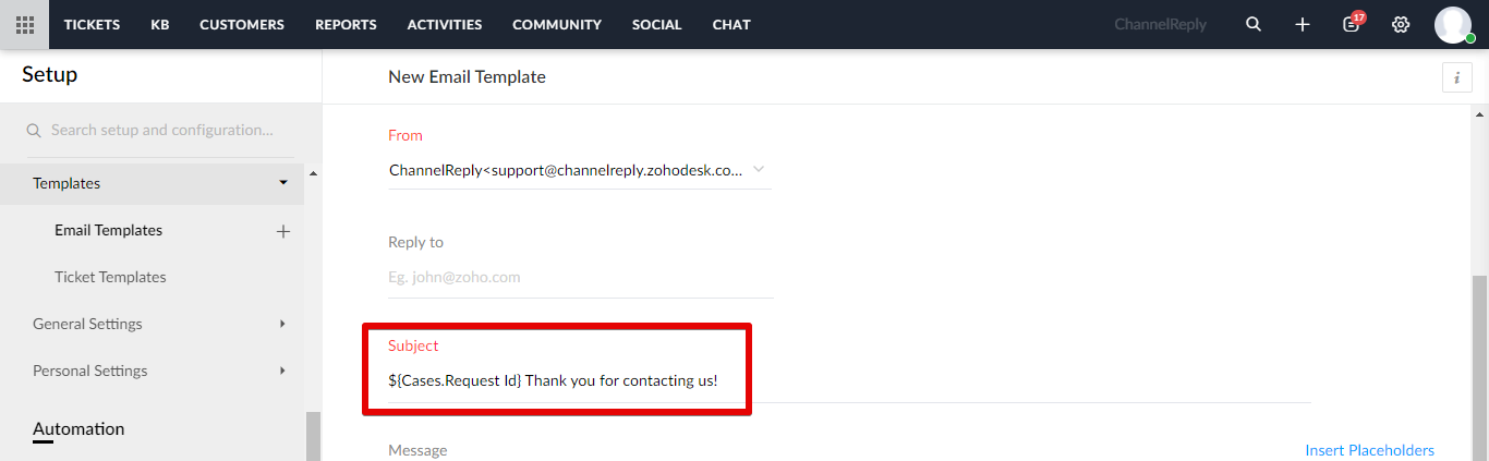

Scroll down. Enter a subject line in the “Subject” field. Note that your subject line must start with the placeholder below:
${Cases.Request Id}
It should have one space between it and the rest of your subject line. While it’s smart to have a good subject line, note that your customers will probably never see it. So, don’t worry about writing a masterpiece!
Subject line beginning with ${Cases.Request Id}

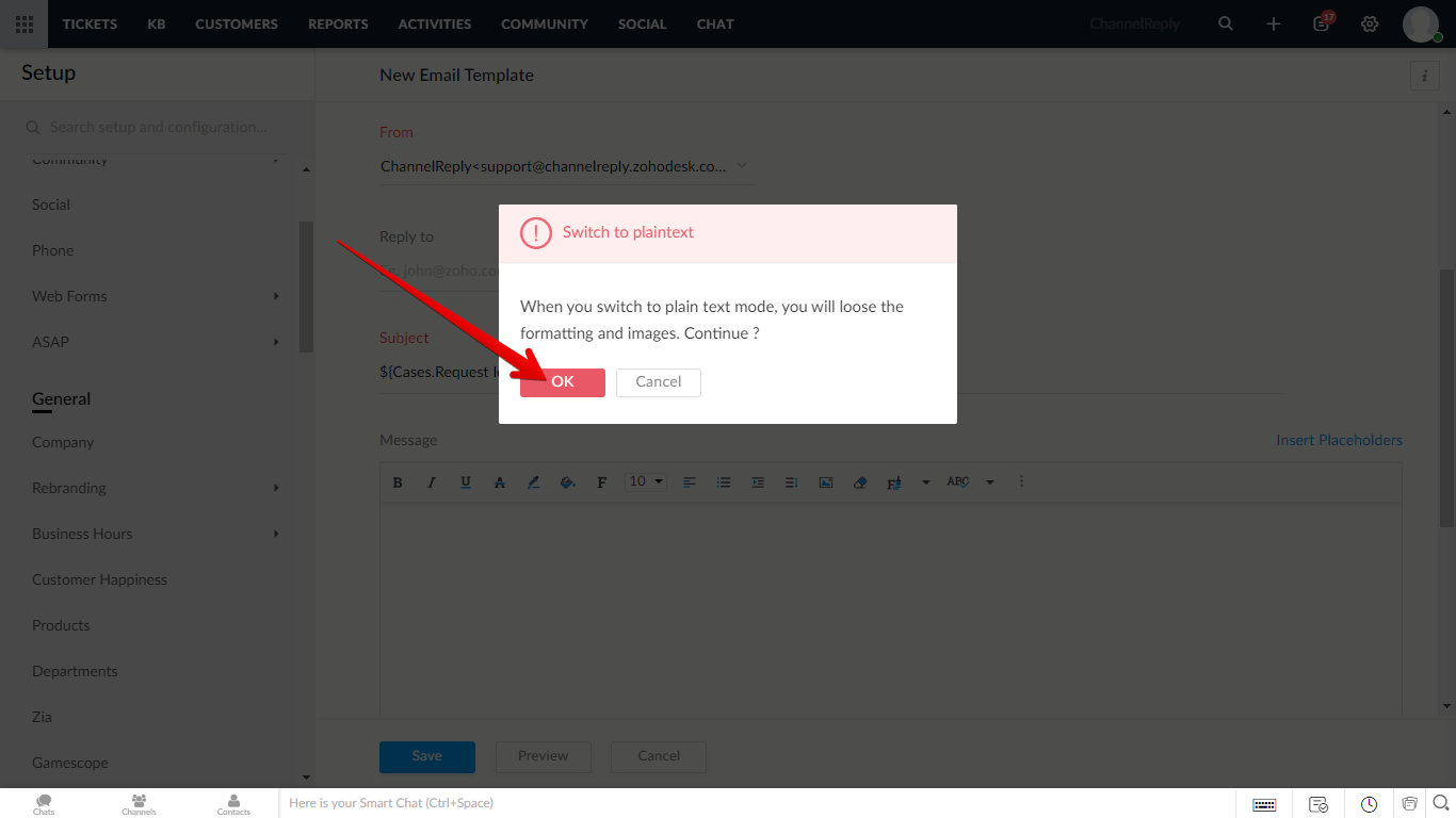

Next, you’ll want to write your message in plain text to make sure no formatting errors appear. Marketplaces often remove formatting anyway, so don’t worry, you’re not losing out! To make the switch, click “More” (the column of three dots on the far right of your formatting options) and then “Plain Text.”
More button and Plain Text option
Hit "OK" to confirm that you want to switch.
OK button on switch to plain text confirmation popover

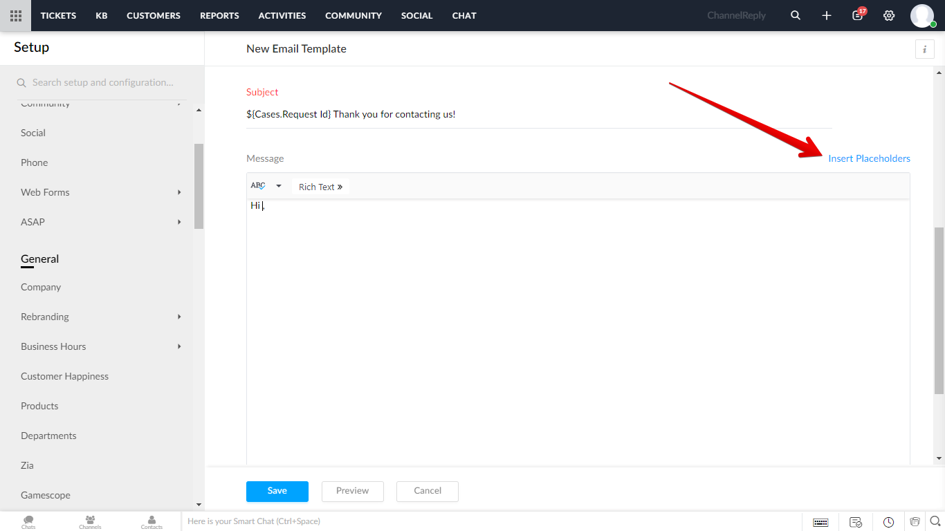

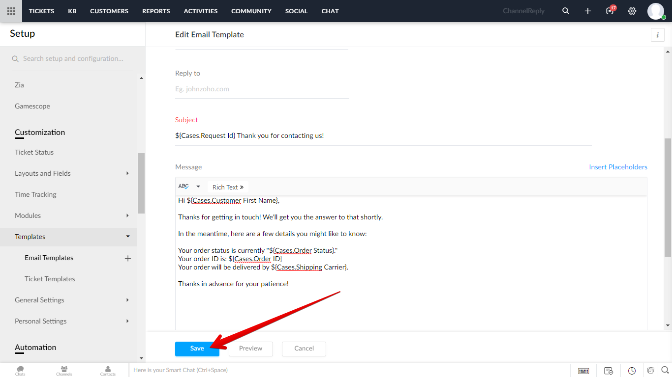

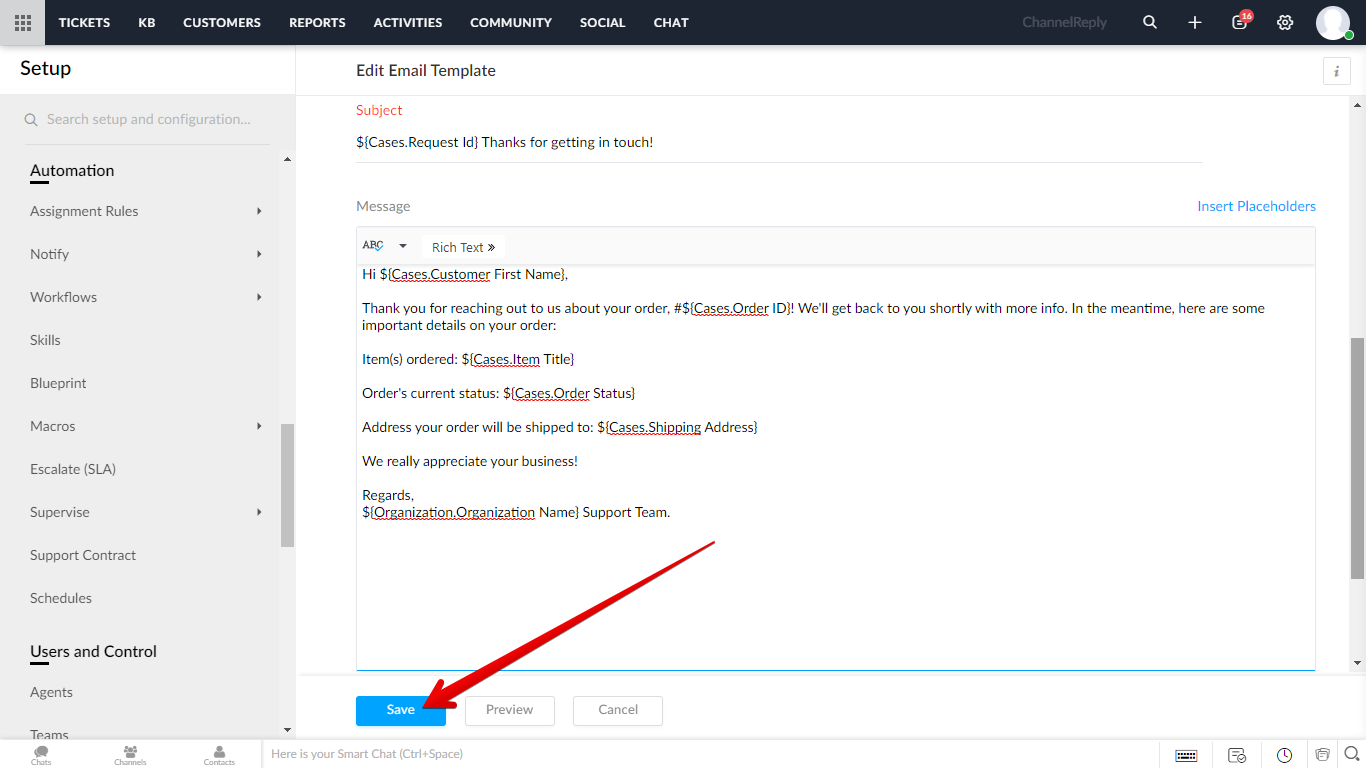

Now you can enter your message in the “Message” field. Note that the custom fields you set up in step 2 will be available in your list of placeholders.
Insert Placeholder button
Entering a ChannelReply custom field as a placeholder in a Zoho Desk template
Using custom field placeholders in your message is highly recommended. They’ll make it more personalized, which will not only be better for the customer, but also protect your message from getting caught by spam filters. It’s the best way to make sure your auto-replies count toward response time SLAs on sites like Amazon.
Be sure to review our custom field definitions to learn which fields are only compatible with certain marketplaces. For example, Delivery Level works with Amazon and Shopify messages, but not eBay, Walmart or Back Market. You can target your autoresponder at specific marketplaces, so feel free to specialize this message to one or two of them.
You should also be careful to avoid including any links or contact information at all. Links often break marketplace rules and can get you in trouble!
Once you’re happy with your message, click “Save.”
Save button on an email template

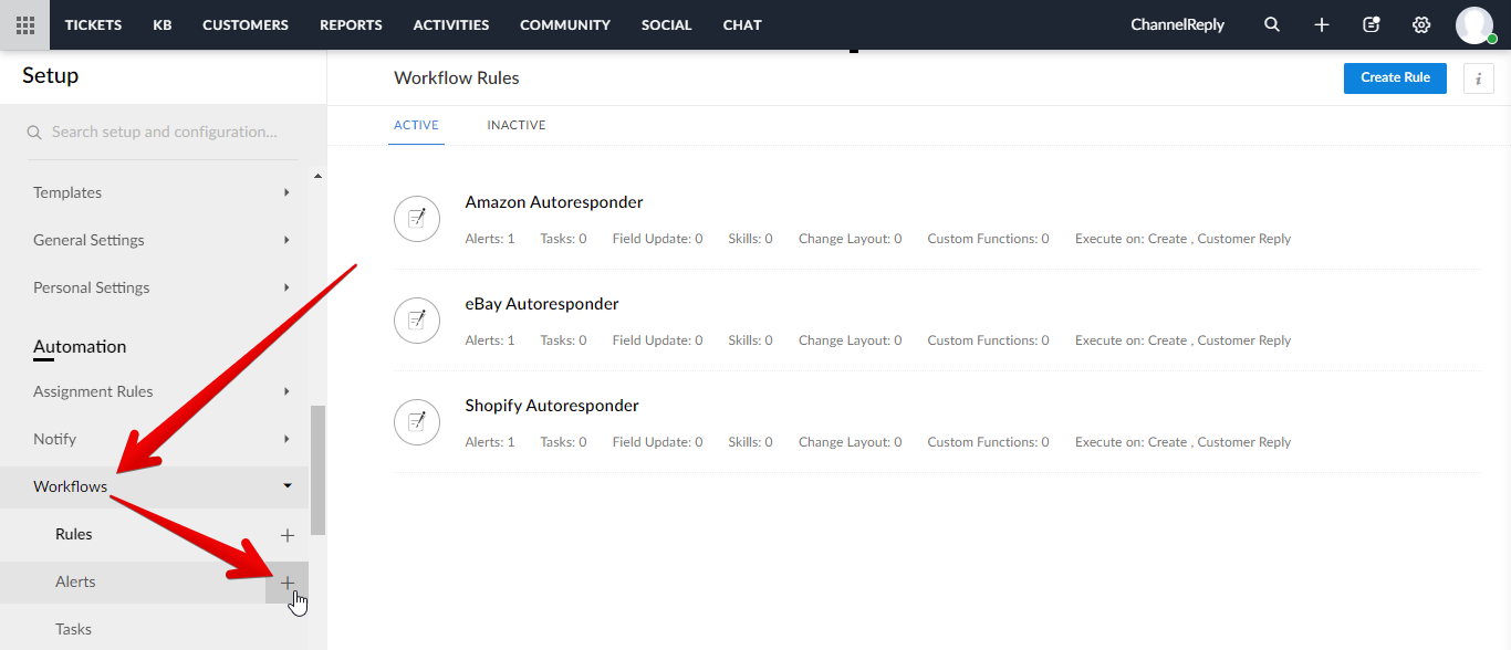

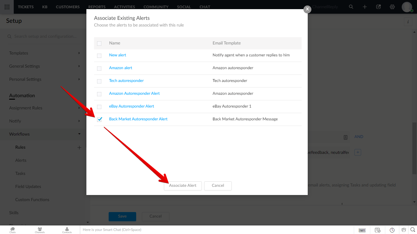

AS 4. Create an Alert

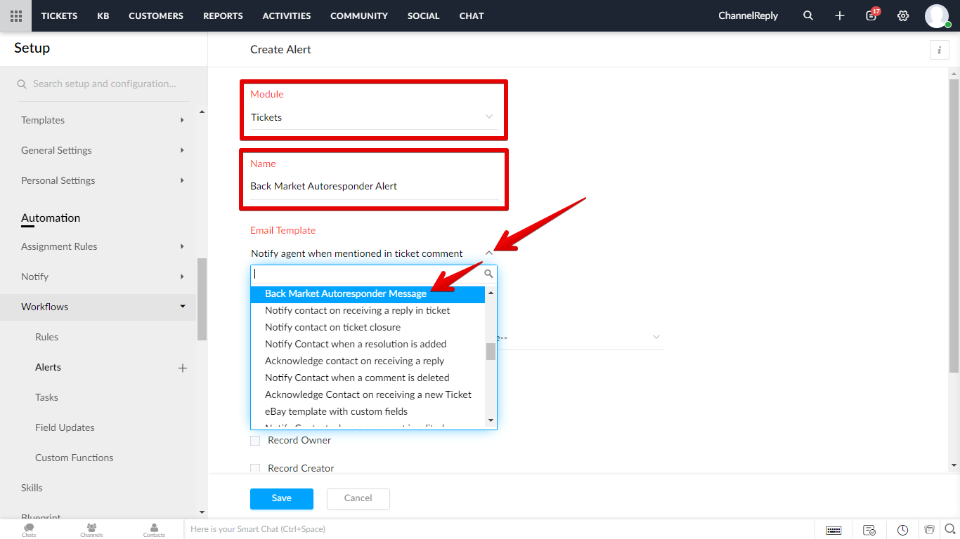

In order to actually send your template, it will need to be built into an alert. Open the “Workflows” submenu in the left-hand menu. Mouse over “Alerts” and hit the plus sign that appears.
Workflows dropdown menu and plus sign appearing next to Alerts when moused over
Under “Module,” select “Tickets.”
Give the alert an easily recognizable name, like “Amazon Autoresponder Alert.”
Then, under “Email Template,” select the template you just created.
Module set to Tickets, Name field filled in, and selecting a template from the Email Template dropdown

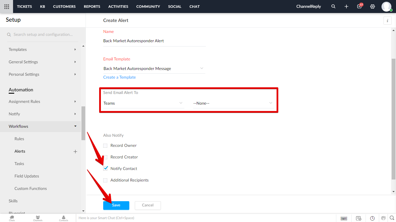

Leave “Send Email Alert To” set to Teams | --None--
Under “Also Notify,” check “Notify Contact.”
Finally, click “Save.”
Send Email Alert To set to Teams | --None--, Notify Contact checked, and Save button

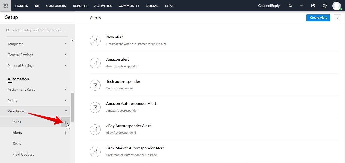

AS 5. Create Your Autoresponder Workflow
The “Workflows” submenu should already be open in your left-hand sidebar. Mouse over “Rules,” then hit the plus sign that appears.
Plus sign appearing next to Rules when moused over in the Workflows submenu

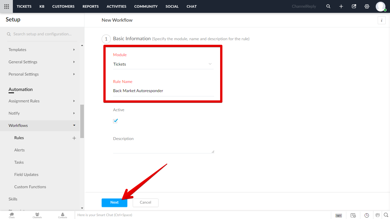

AS 6. Fill In Basic Information
Leave the module set to “Tickets.” Give the rule a name that describes what you want it to do, like “Amazon Autoresponder” or “Shopify and eBay Autoresponder.” Finally, hit “Next.”
Module set to Tickets, Rule Name filled in, and Next button

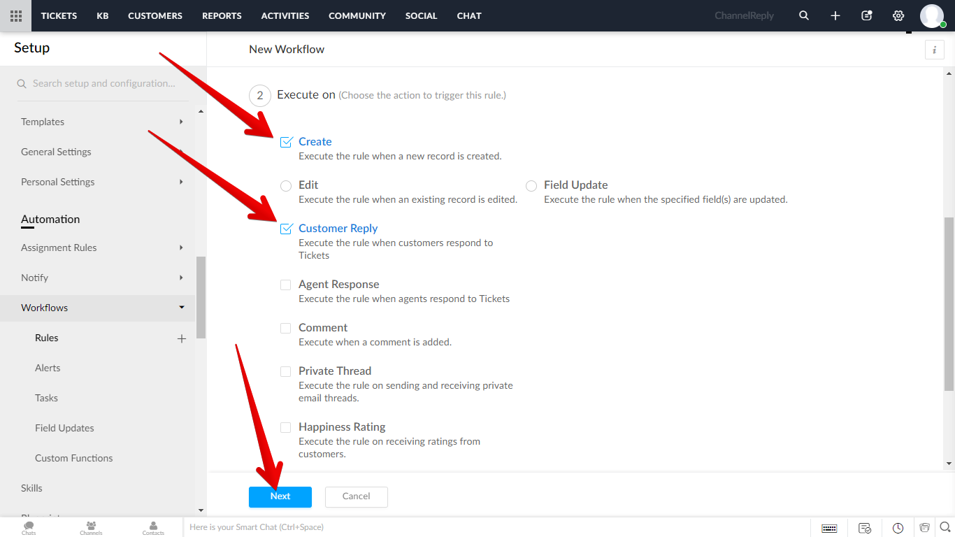

AS 7. Use “Execute on” to Choose How Often to Send Autoreplies
Under “Execute on,” decide what to check:
  • Check only “Create” if you just want to auto-reply to the first message in each ticket.
  • Check only “Customer Reply” if you want this autoresponder only to reply to follow-up messages from the customer. (This is a good option if you already set up a “Create” autoresponder and want a different message for follow-ups than for the initial response.)
  • Check both “Create” and “Customer Reply” if you want this to auto-reply to both the initial message and all customer follow-ups in a ticket.
Once you’re happy with your settings, click “Next.”
Execute On settings with Create and Customer Reply checked, plus the Save button indicated

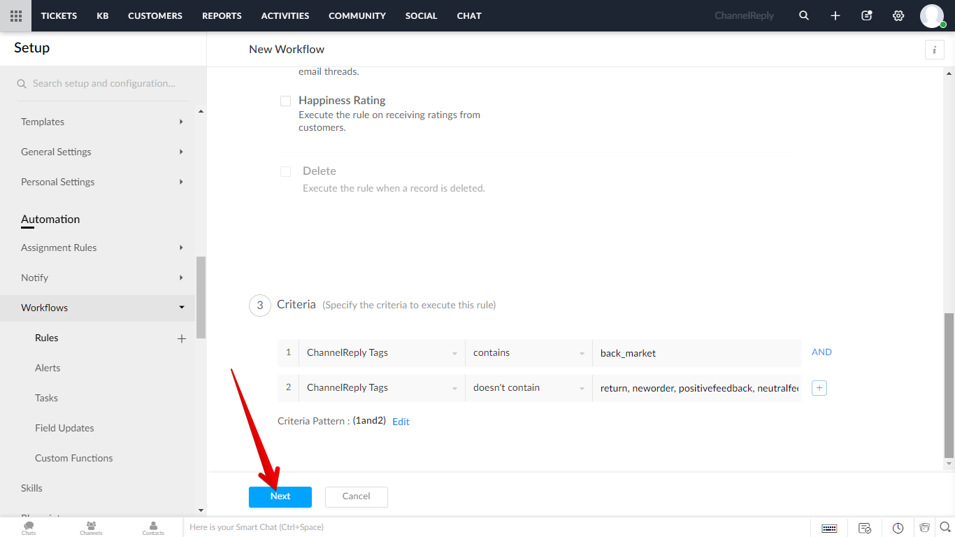

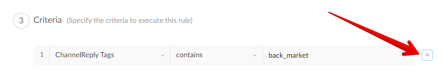

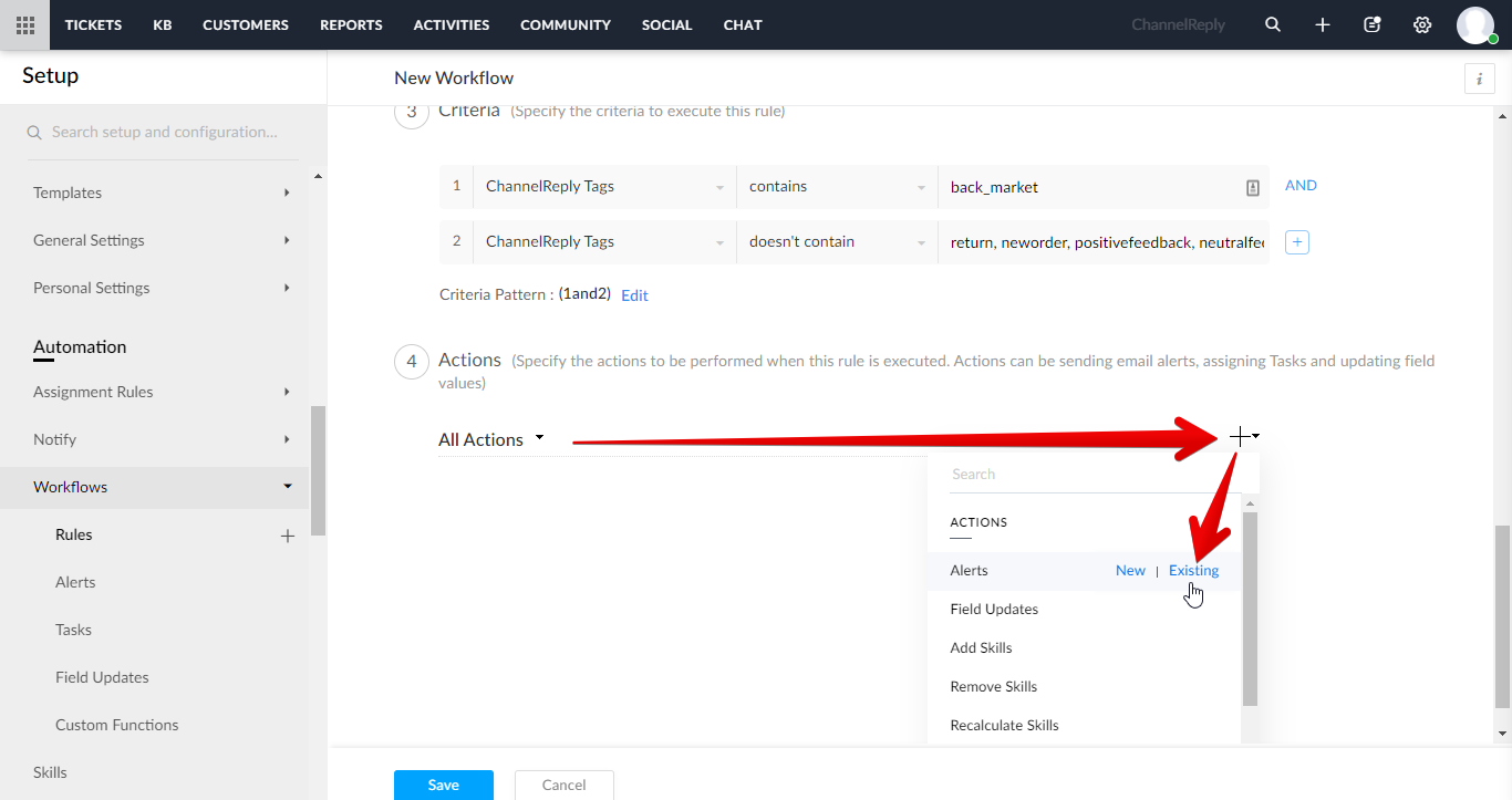

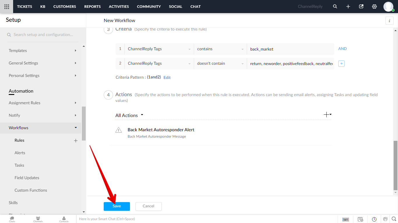

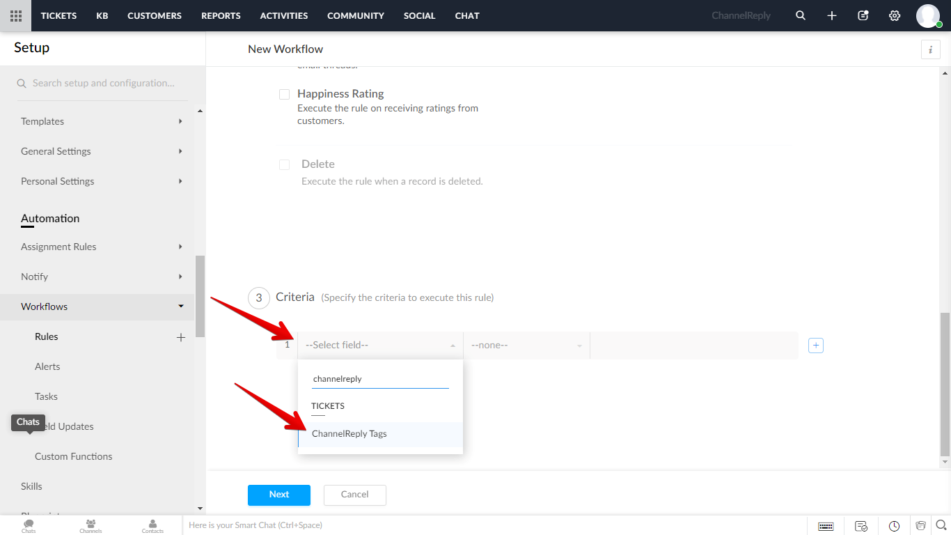

AS 8. Set Criteria
If you are perfectly happy with this autoresponder replying to every single ticket that comes into Zoho Desk, you don’t need to set any criteria. You can just hit “Next” and skip to step 9. However, most sellers will want to set at least some criteria!

Hit “Select field” and choose “ChannelReply Tags” as your first criterion.
Choosing ChannelReply Tags in workflow criteria
Set the criterion to:
ChannelReply Tags | contains | [the ChannelReply tags of any account you want this autoresponder to reply to]
ChannelReply Tags | contains | back_market
We also recommend excluding our special notifications by default. To add another criterion, click the blue plus sign on the right.
Blue plus sign for adding another criterion to an autoresponder
Set the second criterion to:
ChannelReply Tags | doesn’t contain | [all tags from the comma-separated list of all automatic ChannelReply tags]
Once you’re happy with your criteria, hit “Next.”
Next button after recommended ChannelReply Tags settings have been configured

AS 9. Set the Action to Your Alert
Hit the black plus sign to the right of “All Actions.” Mouse over “Alerts” and choose “Existing.”
Plus sign next to All Actions, Alerts moused over in the Actions dropdown, and Existing appearing on the right
Check the box next to the alert you created earlier, then click “Associate Alert.”
Checking the box for the template created earlier and clicking Associate Alert
Save button on finalized autoresponder worfklow
At last, your autoresponder is complete and active! It will now send autoreplies to all messages that meet your criteria.
Auto-reply appearing on a Zoho Desk ticket
Auto-reply in Back Market
