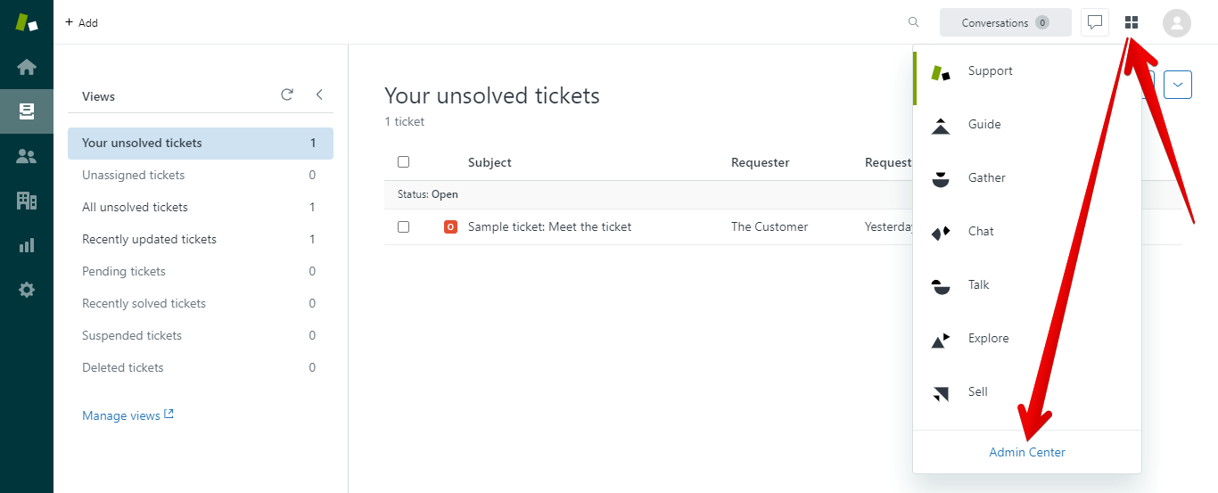

In Zendesk, click Products (the four-squares icon in the upper right), then Admin Center.
Zendesk Products menu and Admin Center button

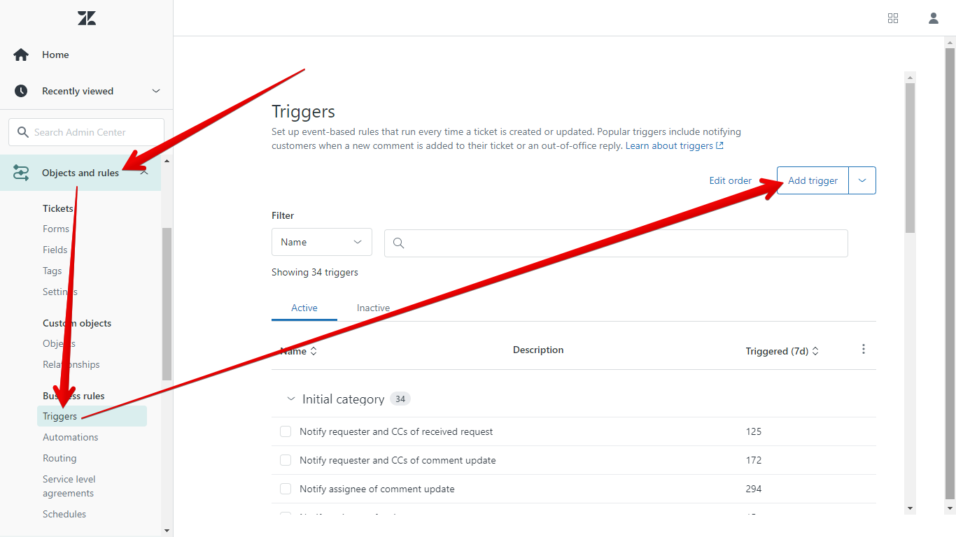

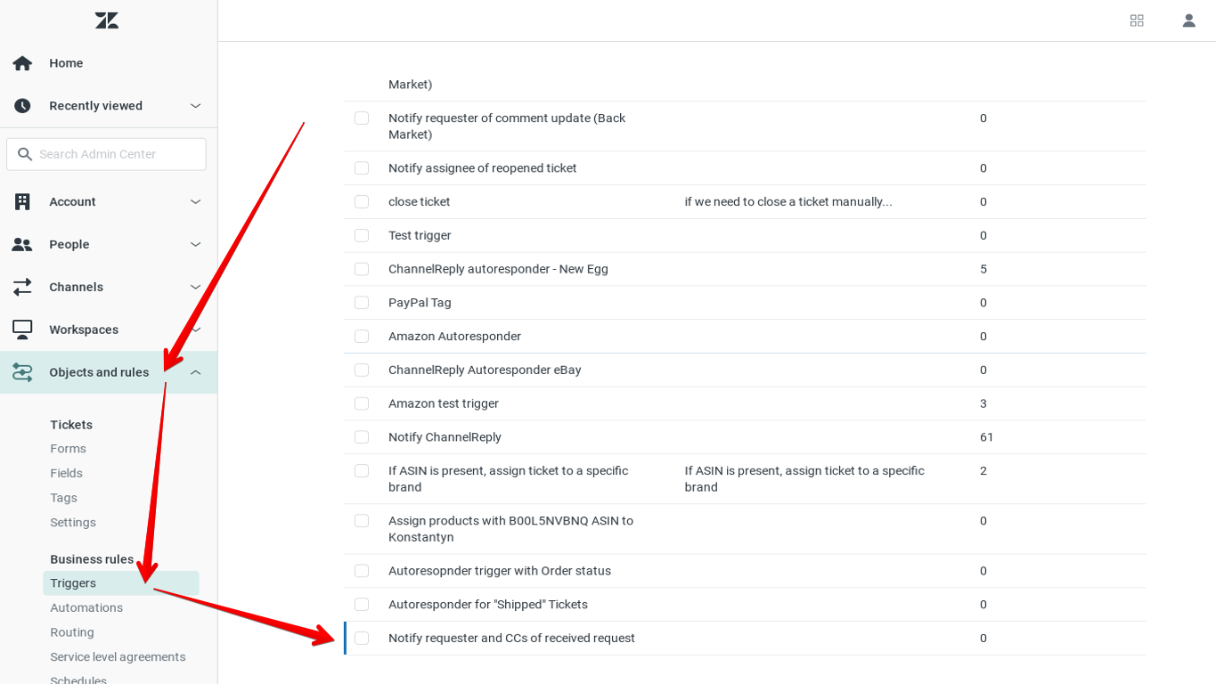

Open the "Objects and rules" menu, then click Triggers. Find "Notify requester and CCs of received request."
Zendesk Admin menu, Triggers submenu, and Notify requester and CCs of received request trigger

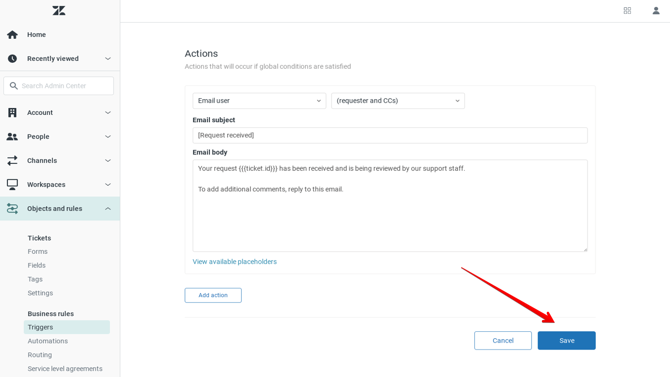

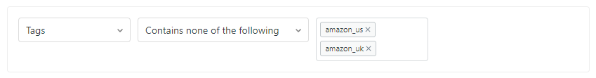

Edit the trigger and make sure it has the following ALL condition:
Tags | Contains none of the following | (Your ChannelReply tags)
Here’s an example for someone with two Amazon accounts, one tagged with “amazon_us” and the other “amazon_uk”:
Trigger condition excluding Amazon accounts by tags
This stops Zendesk’s default auto-reply from trying to answer marketplace messages. It will still work for normal emails.
Click “Save” at the bottom of the screen. This will save your changes and return you to the Triggers menu. (If you already had the right conditions set up and can’t save, hit “Cancel” instead.)

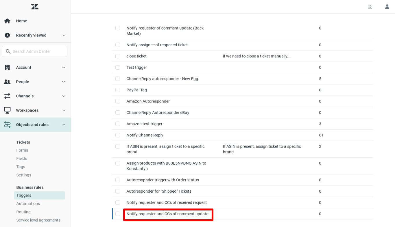

Next, edit the default trigger "Notify requester and CCs of comment update." (This is different from “Notify requester and CCs of received request,” the trigger you just edited.)
Notify requester and CCs of comment update trigger
Under “Meet ALL of the following conditions,” make sure you have the same condition:
This will ensure your customers never get two copies of your responses.

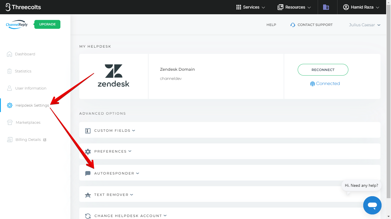

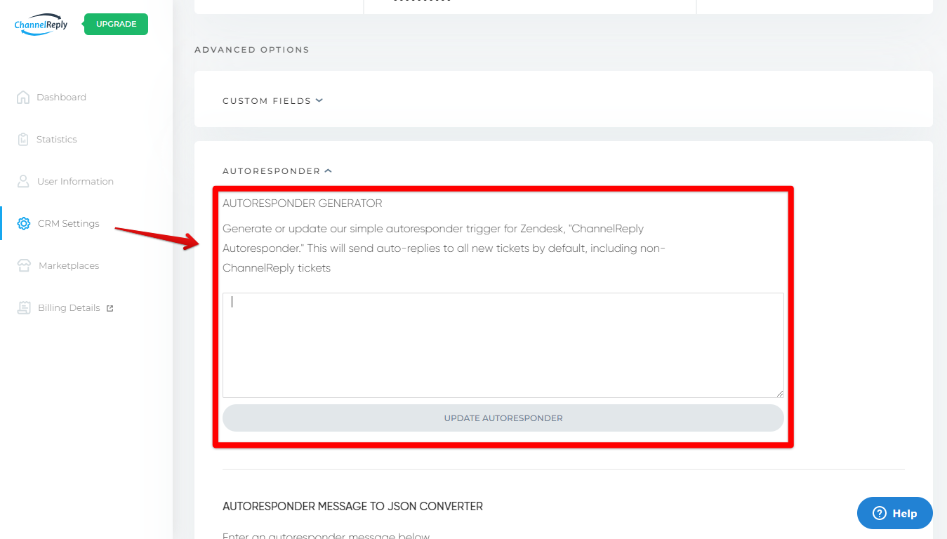

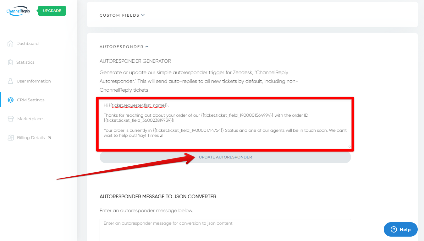

Visit your ChannelReply dashboard and click "Helpdesk Settings" in the left-hand menu. Then open the "AUTORESPONDER" dropdown.
Helpdesk Settings and Autoresponder Dropdown in ChannelReply

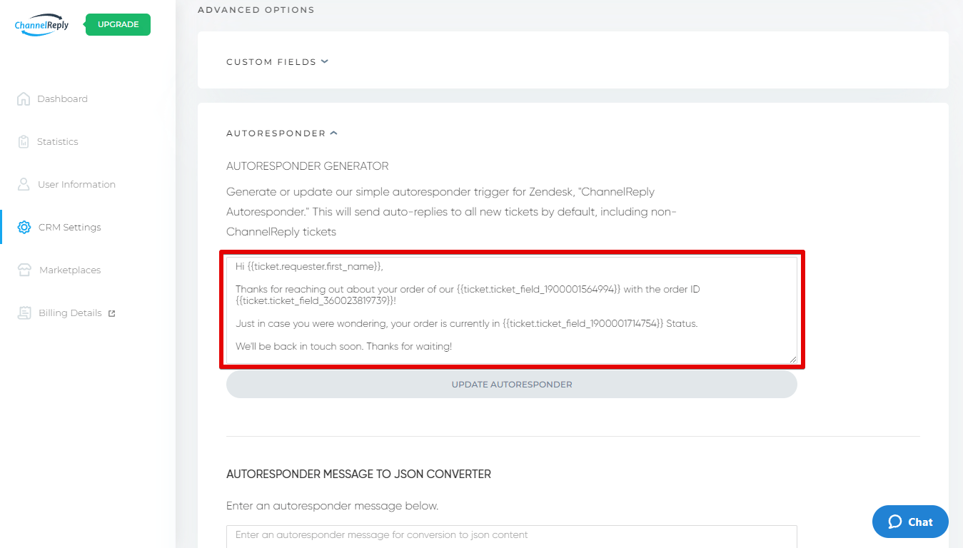

You will see the autoresponder generator tool at the top of the menu that appears.
ChannelReply's autoresponder generator tool
Enter your auto-reply in the autoresponder generator. You can include any Zendesk ticket fields like {{ticket.requester.first_name}}. You can also include placeholders made with ChannelReply custom fields.
Once you’re happy with your auto-reply, click “UPDATE AUTORESPONDER.”
UPDATE AUTORESPONDER button
This will create the trigger “ChannelReply Autoresponder” inside your Zendesk account. This is a very basic autoresponder that will send your auto-reply to only the first message of every ticket. Note that it will reply to both ChannelReply and non-ChannelReply tickets at first.

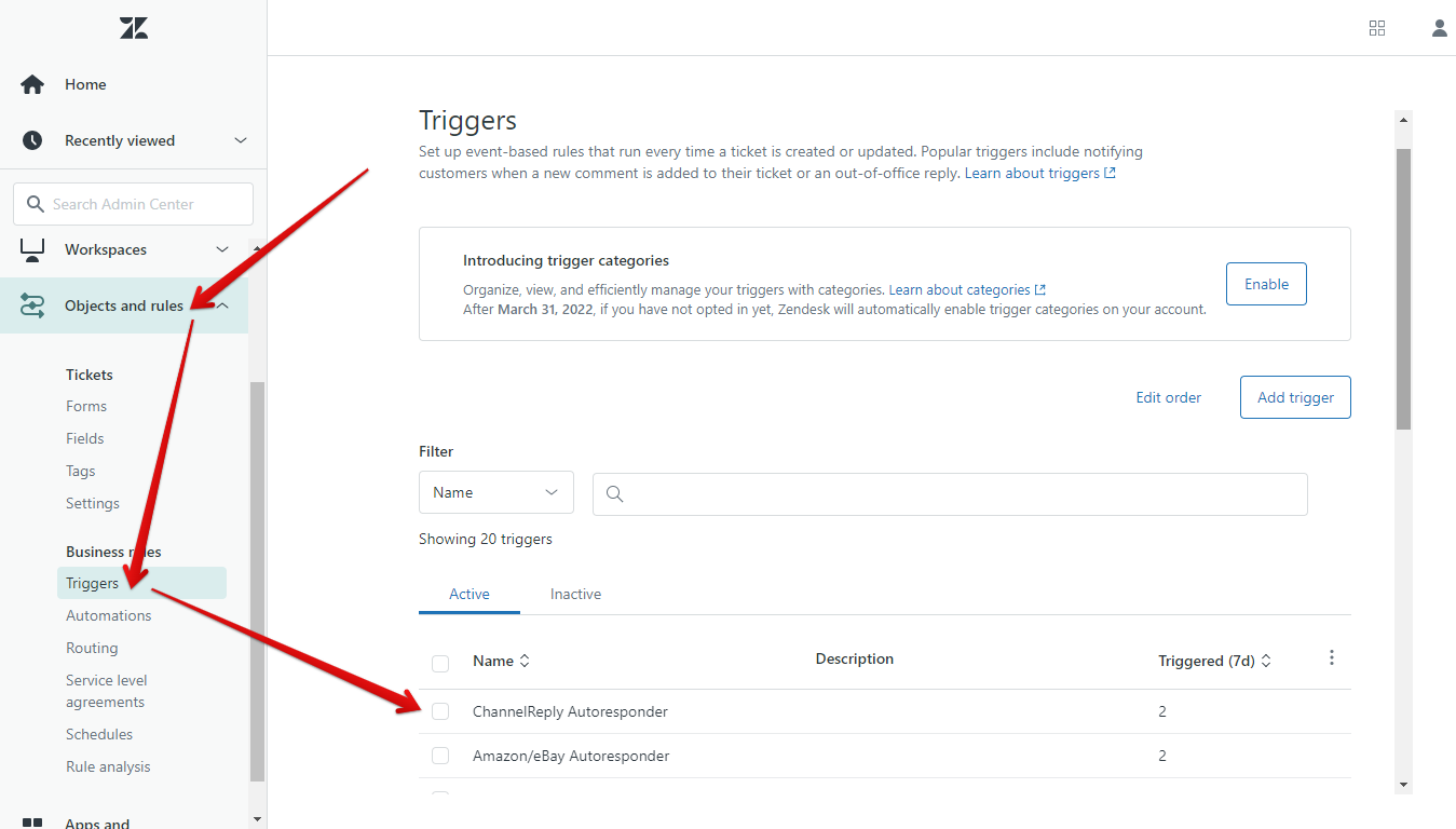

Return to your Zendesk Admin Center screen. The "Objects and rules" menu and "Triggers" submenu should already be open. Find "ChannelReply Autoresponder" in your list of active triggers and click on it to begin editing.
Objects and rules menu, Triggers submenu, and ChannelReply Autoresponder trigger in Zendesk Admin Center

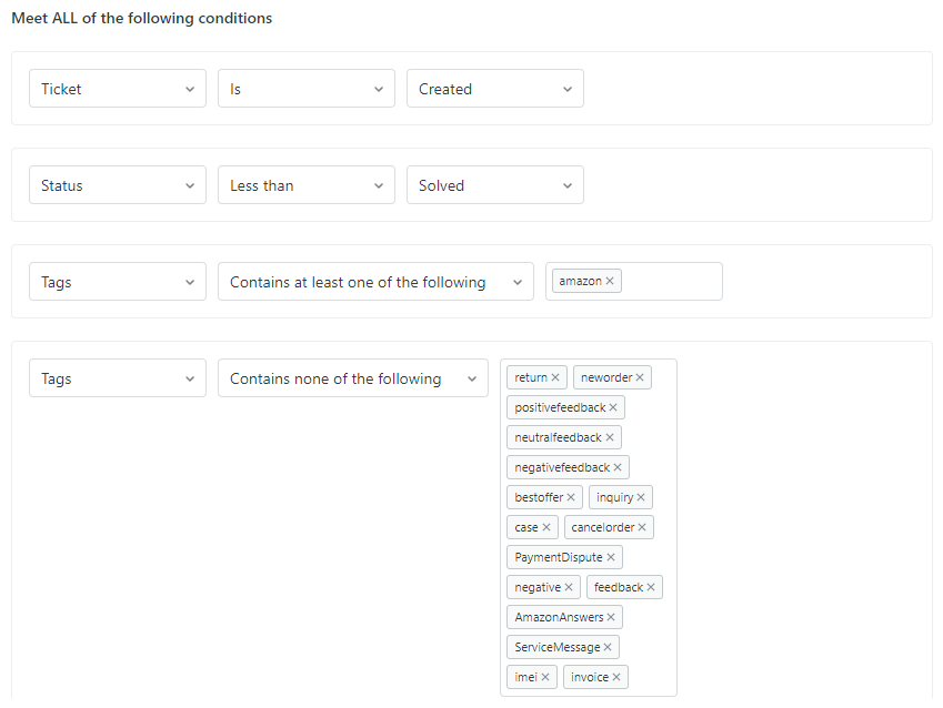

If you don’t want to auto-reply to all your tickets, simply add the following under “Meet ALL of the following conditions”:
Tags | Contains at least one of the following | (Your ChannelReply tags)
Tags settings for a Walmart, Shopify, Newegg, Back Market, eBay and Amazon autoresponder in Zendesk
It’s up to you which of your marketplace accounts your autoresponder will answer. It all depends on which ChannelReply tags you enter.
So, if you want to auto-reply to all your Amazon, eBay, Back Market, Shopify and Walmart customer messages, add all of your ChannelReply tags. If you only want this to work as an Amazon autoresponder, then only enter your Amazon tags:

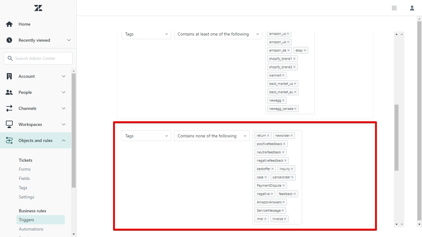

We also recommend excluding our special notifications from your autoreplies. Otherwise, you could send autoresponses to things like eBay Resolution Center cases, which might not be ideal! To avoid this kind of situation and also prevent lots of "Could not deliver your reply" error messages, add the following "ALL" condition:
Tags | Contains none of the following | [All tags from the comma-separated list of all automatic ChannelReply tags]
Tags settings for preventing Zendesk from autoreplying to special ChannelReply notifications

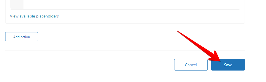

When you've finished making changes, remember to click "Save" at the bottom of the screen.
Save button on a Zendesk trigger

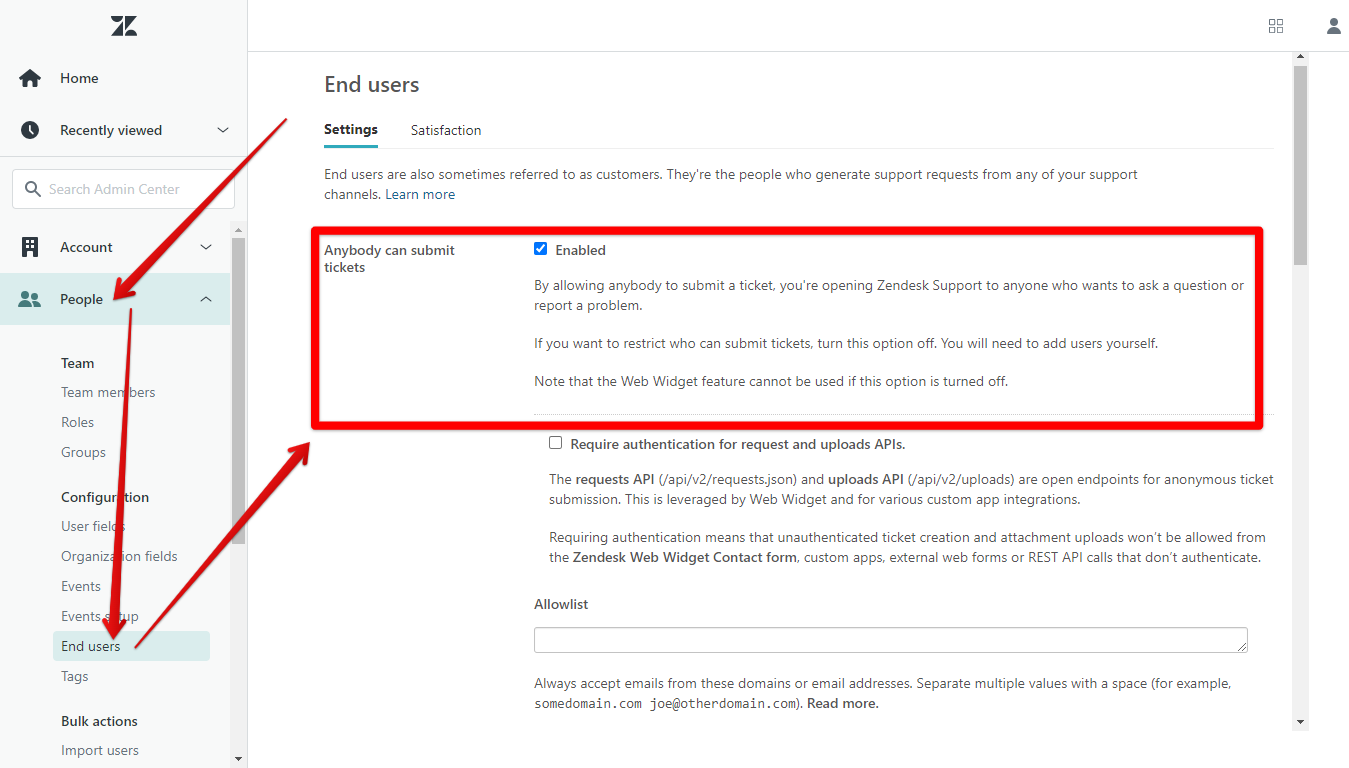

The setup for auto-replying to follow-up messages depends on your Zendesk settings. Check whether both of the following statements are true:
Statement 1. In Admin Center > People > End Users, “Anybody can submit tickets” is enabled.
"Anybody can submit tickets" option enabled in Zendesk

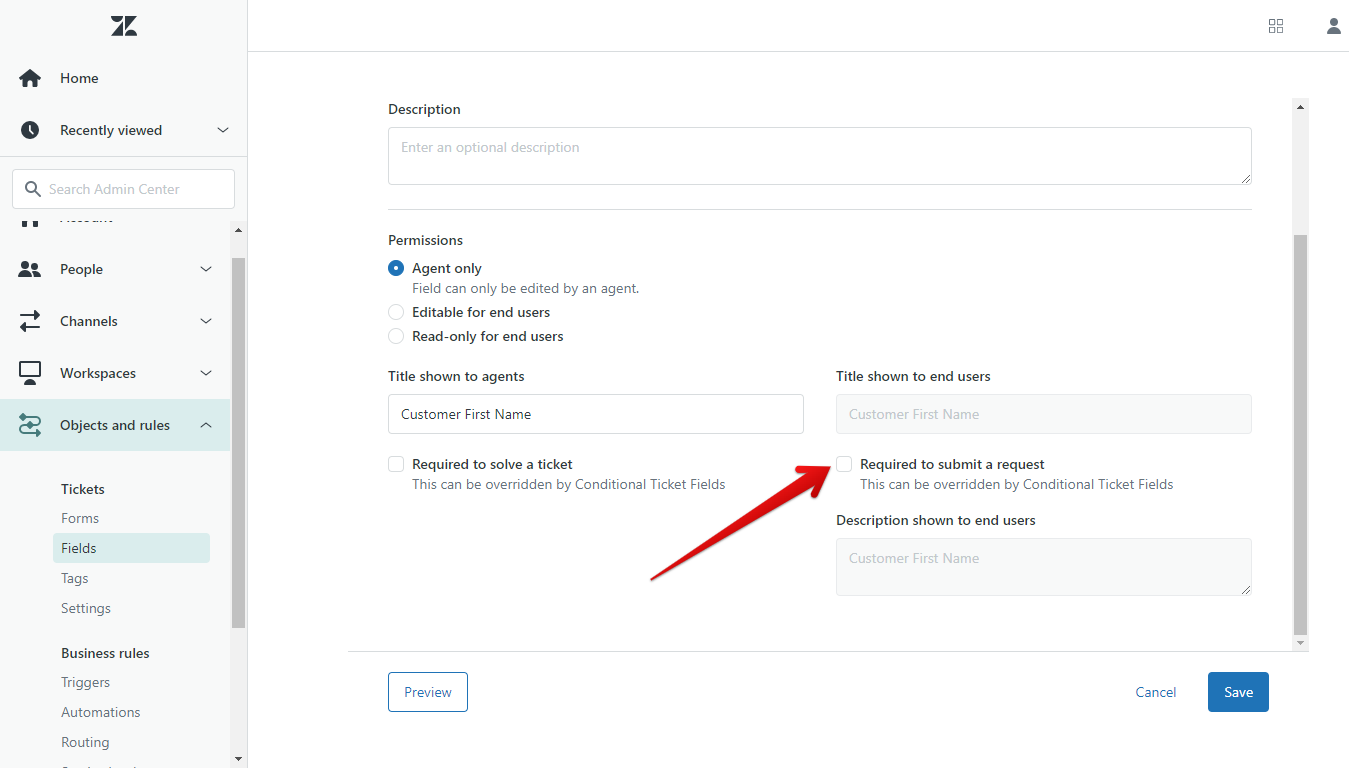

Statement 2. None of your custom fields have “Required to submit a request” turned on.
This includes all custom fields that you have created in Zendesk, whether or not you used ChannelReply to make them.
Note that you do not have to check Zendesk's default ticket fields. Also, “Required to submit a request” is turned off by default for ChannelReply custom fields. You can assume it’s turned off for our fields if you know nobody has changed any field settings.

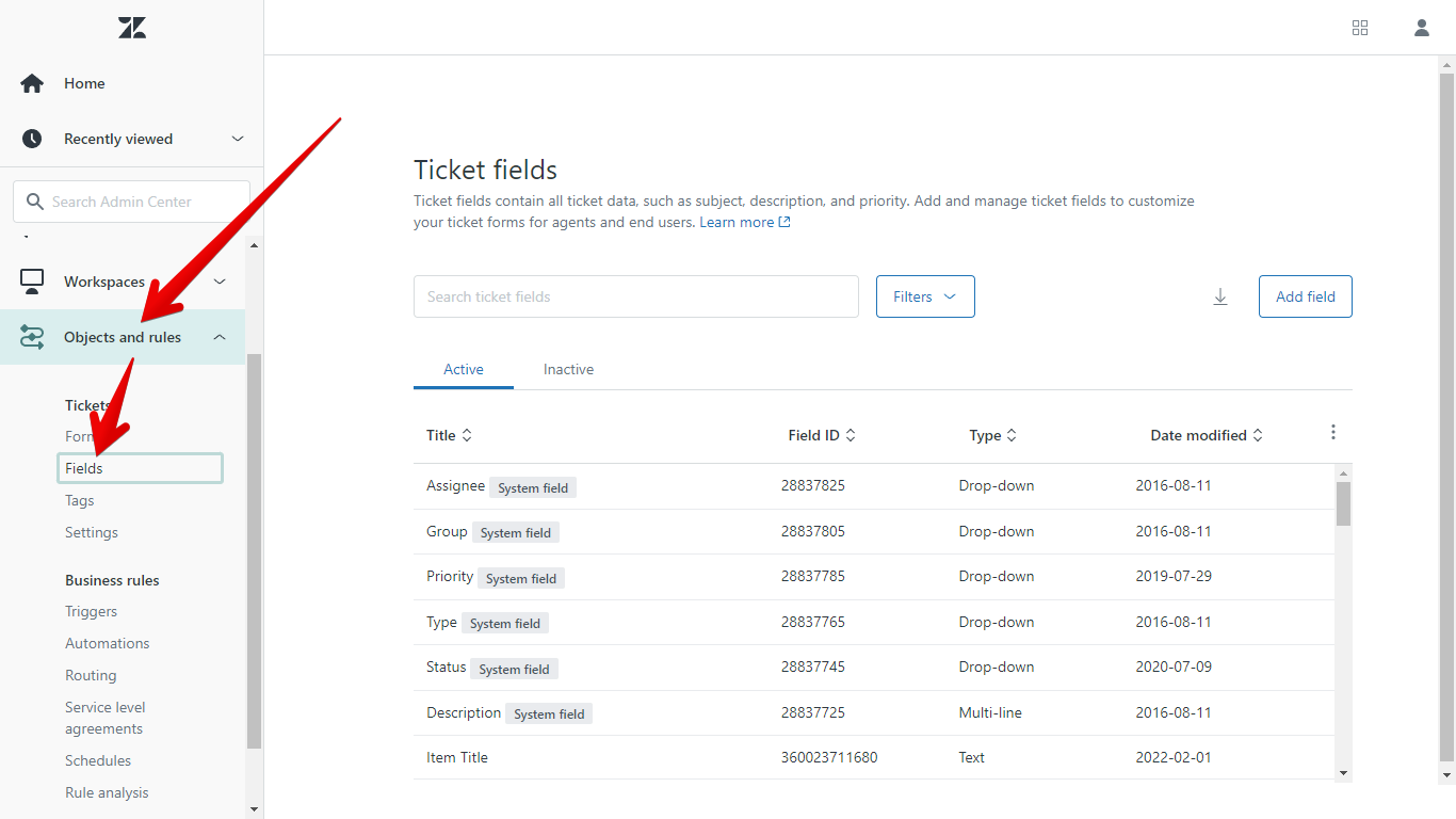

To check this setting, go to Objects and rules > Fields.
Admin menu and Ticket Fields submenu in Zendesk
Click on any custom field to open it. You'll then see the "Required to submit a request" option, among many other settings.
"Required to submit a request" option turned off for a specific ticket field

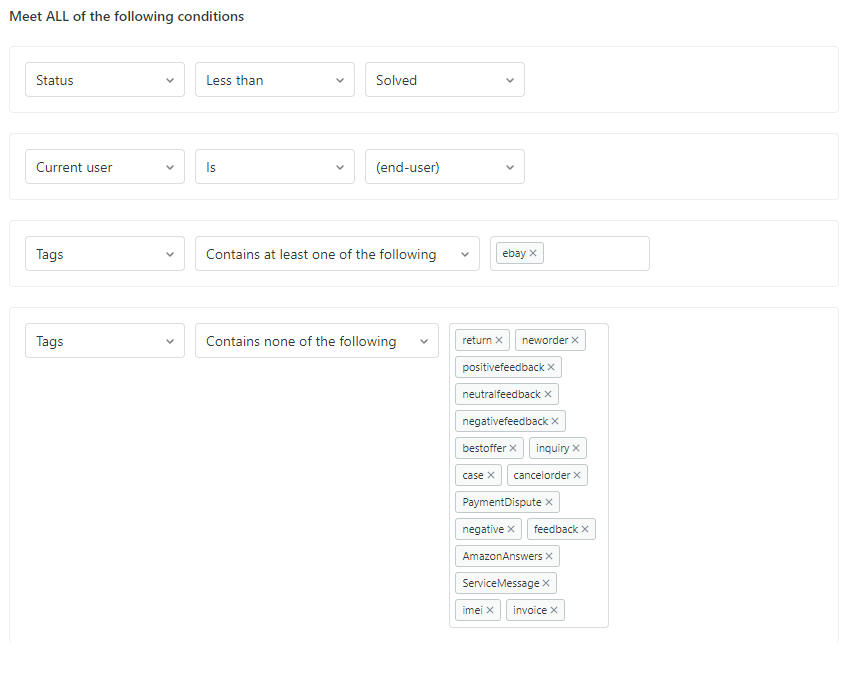

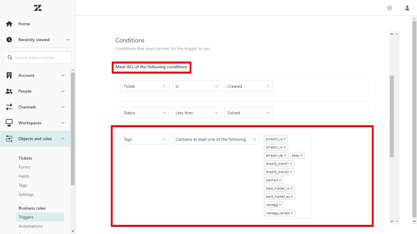

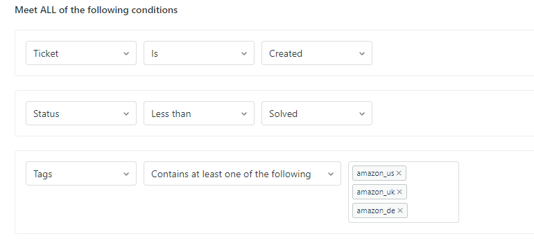

Reopen your ChannelReply Autoresponder trigger. Change the ALL conditions to the following:
Status | Less than | Solved
Current User | Is | (end-user)
Meet ALL of the following conditions settings for an eBay autoresponder trigger conditions for Zendesk

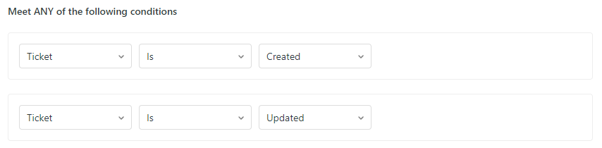

Then add the following ANY conditions:
Ticket | Is | Created
Ticket | Is | Updated
Meet ANY of the following conditions settings to reply to all messages in Zendesk
Finally, scroll all the way down and click “Save.”

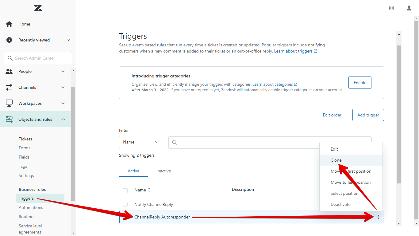

You’ll need to create two autoresponder triggers. The one that was already created will be used to answer the first message in each new ticket. The second will answer any follow-up messages.
Find “ChannelReply Autoresponder” in your list of triggers and mouse over it. Click the column of three dots on the right and choose “Clone.”
How to clone a Zendesk trigger

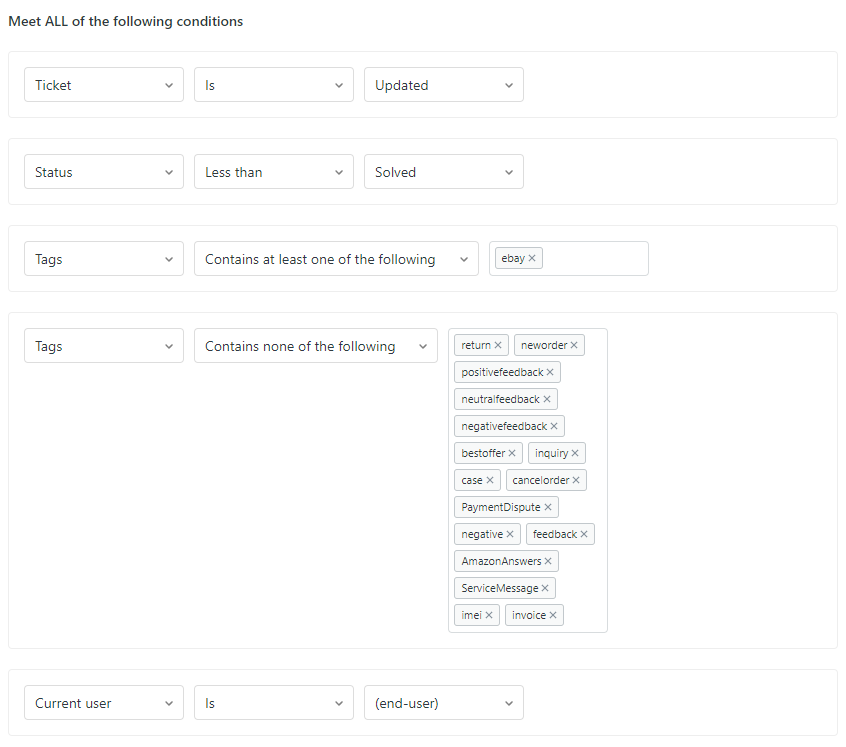

Give the copy a new name, like “ChannelReply Follow-up Autoresponder.” Then change the ALL conditions to the following:
Tags | Contains none of the following |[All tags from the comma-separated list of all automatic ChannelReply tags]
Current user | Is | (end-user)
Zendesk auto-reply settings for answering the first message in every eBay ticket

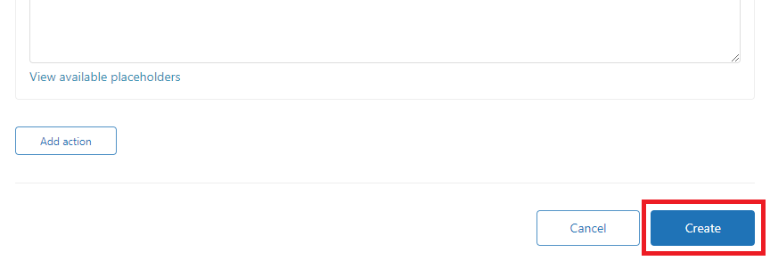

Once you’re finished, scroll down and click “Create.”
Create button

Creating another autoresponder takes much less work. Just clone the trigger you’ve already created, then edit the clone. (If you're using Setup B, clone and edit both triggers you created earlier.) Here’s how to clone and edit:
  • Mouse over your autoresponder in the list of triggers.
  • Click the column of dots on the right, then click Clone.
How to clone the ChannelReply Autoresponder trigger

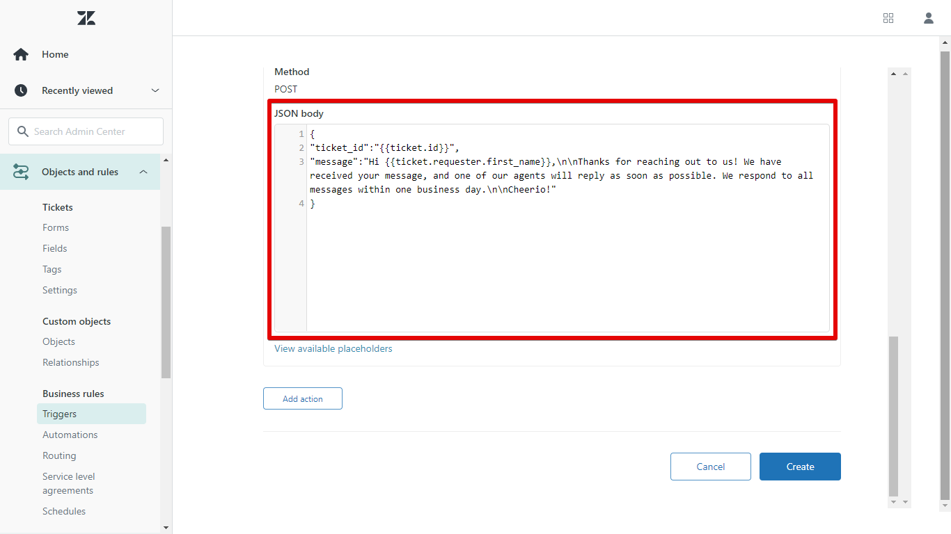

QS 5. (Optional) Edit Your Auto-replies
The original ChannelReply Autoresponder trigger that was automatically generated in step QS 1 is easy to edit. Simply return to your ChannelReply account and go back to Helpdesk Settings > AUTORESPONDER.
Helpdesk Settings menu and Autoresponder dropdown in ChannelReply
Edit the message in the autoresponder generator and click “UPDATE AUTORESPONDER.”
How to update your Zendesk ecommerce autoresponder message from ChannelReply
Your message will be updated without affecting any of your other settings.
Auto-reply translated into JSON code

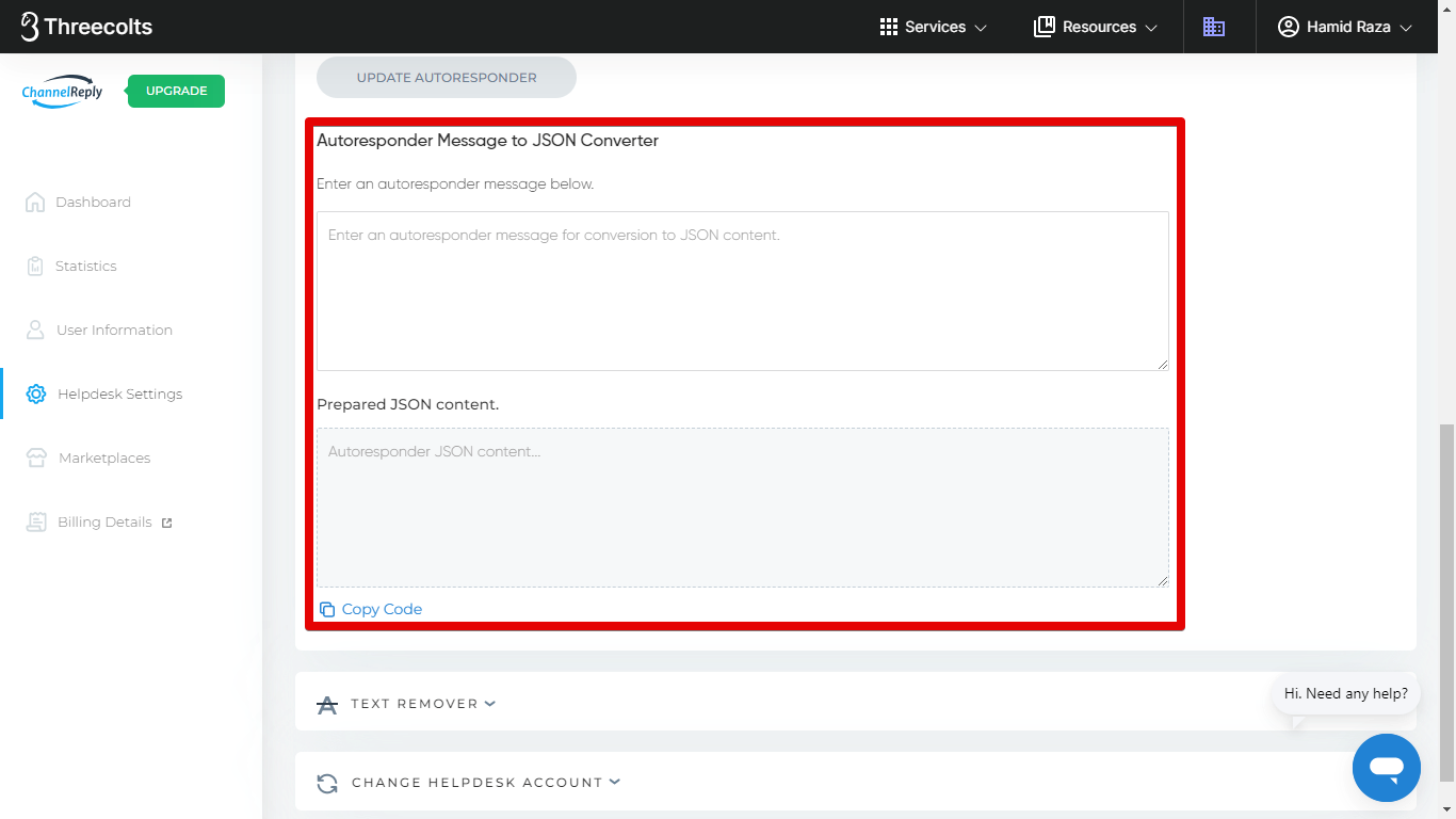

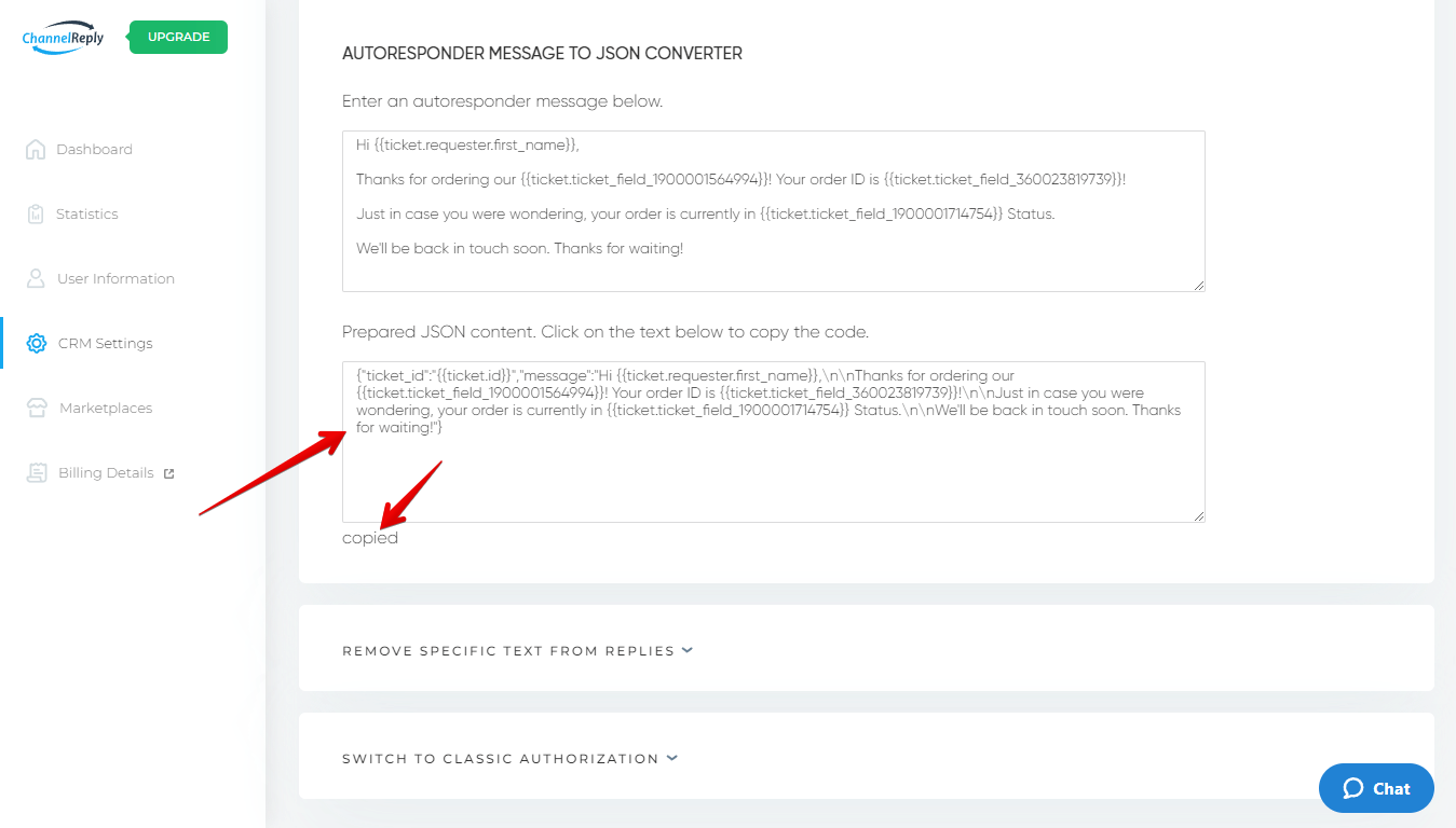

If you created clones of the first autoresponder, though, those are a little trickier to edit. You’ll need your message in JSON code.

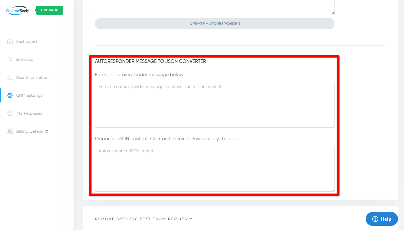

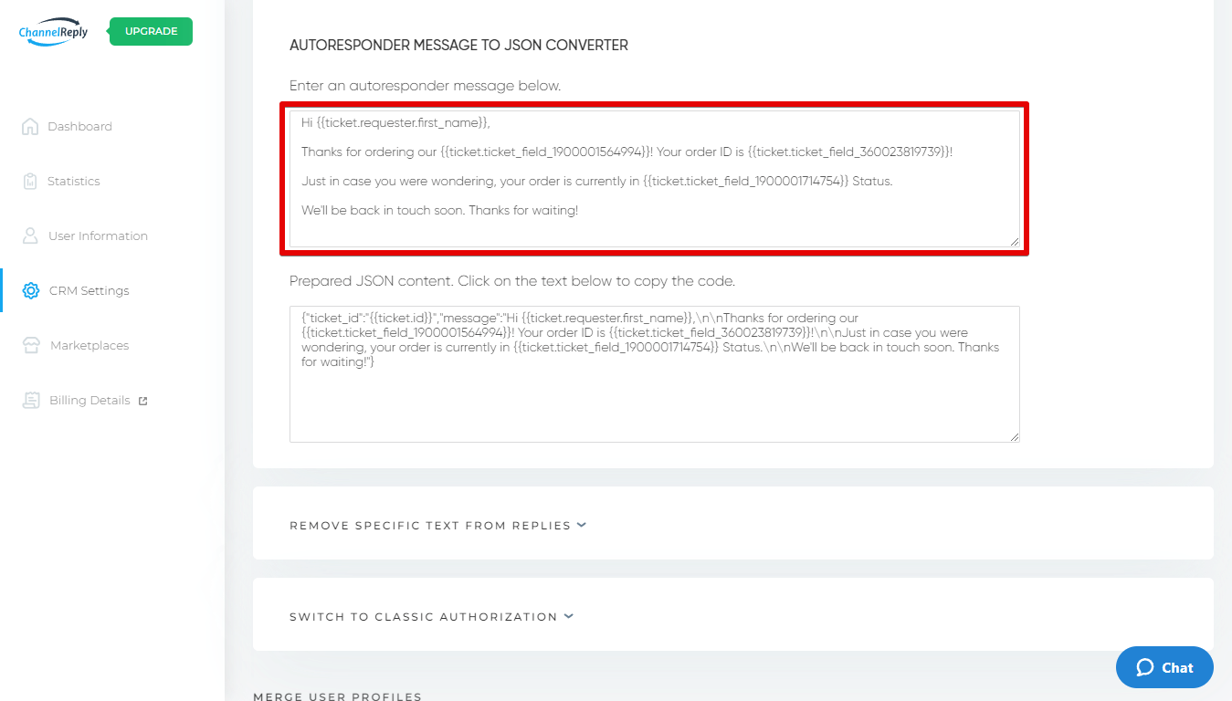

The easiest option is to use our autoresponder-message-to-JSON converter. This tool is found just below the autoresponder generator.
ChannelReply's autoresponder-message-to-JSON converter
Simply type your message into the autoresponder message field. Remember, you can use Zendesk placeholders and ChannelReply custom fields in your reply.
Creating an autoresponder message in ChannelReply's JSON converter
Once done, click anywhere on the prepared JSON content field. This will automatically copy the content.
How to copy JSON content

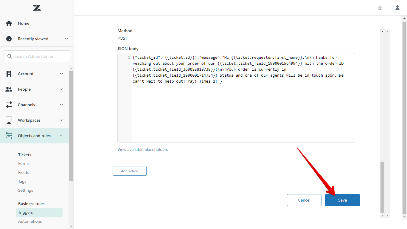

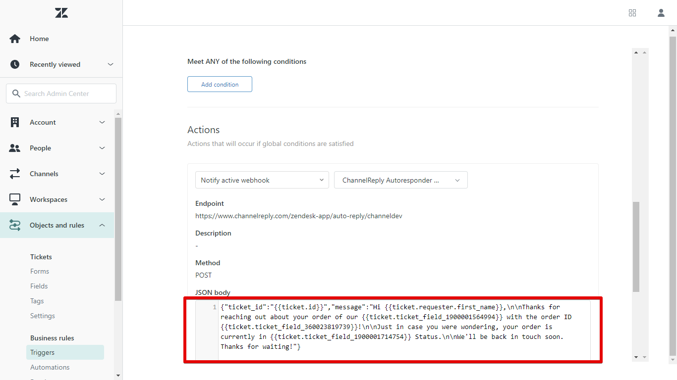

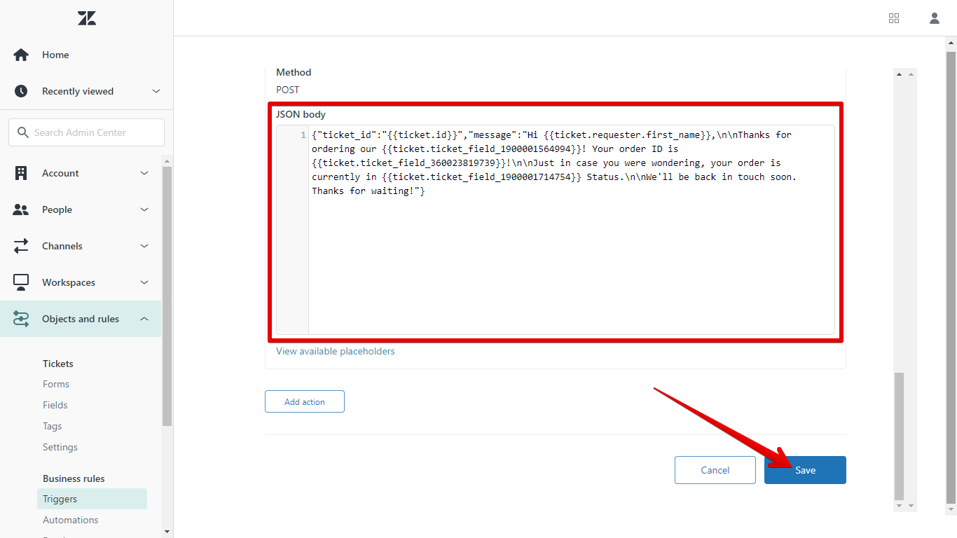

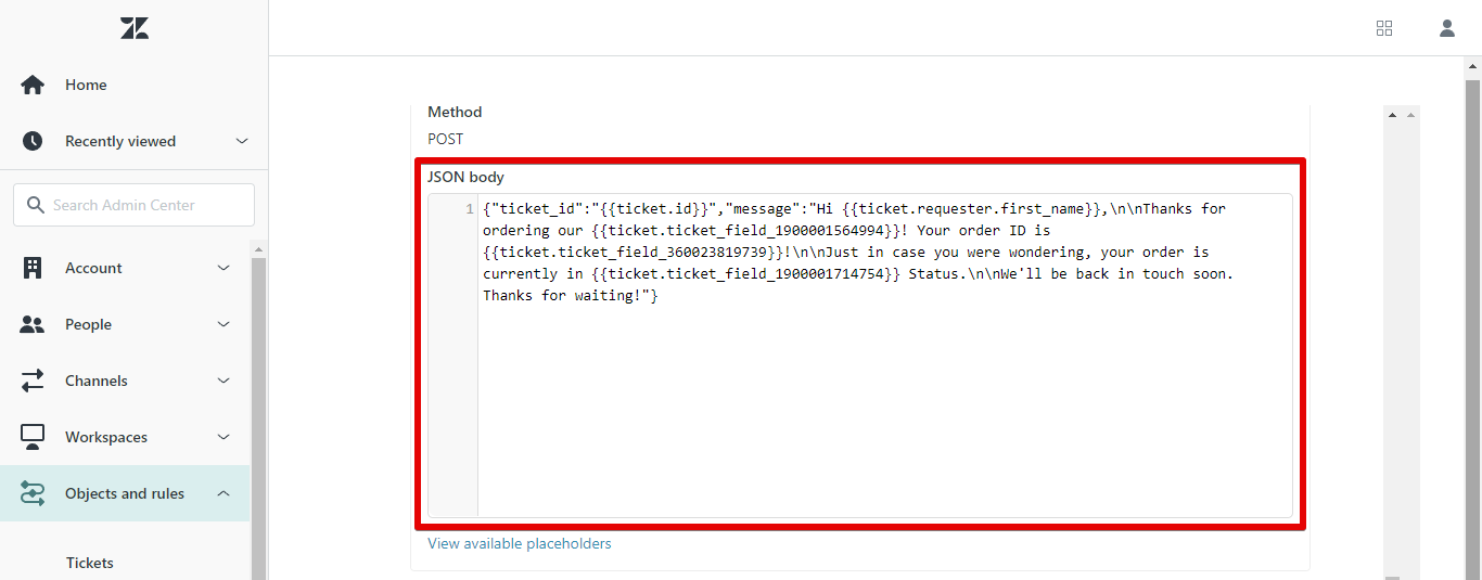

Then return to the autoresponder trigger in Zendesk. Paste your prepared JSON into the “JSON body” field near the bottom of the screen. Hit “Save” and your message update is complete!
Auto-reply example in the JSON body field, and the Save button

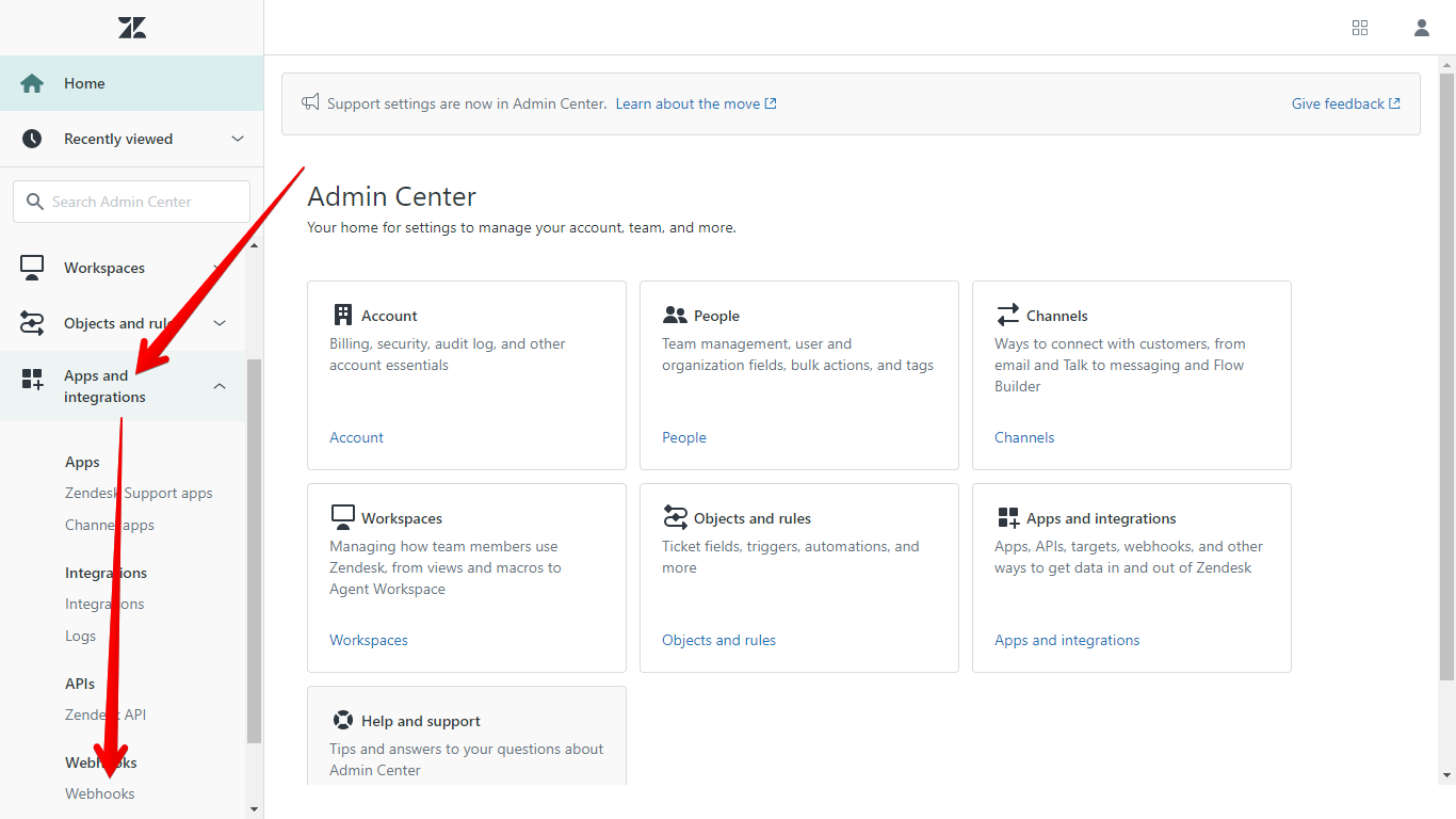

In your Zendesk Admin Center, open the “Apps and integrations” menu. Choose “Webhooks.”
Webhooks in the Zendesk Apps and Integrations menu

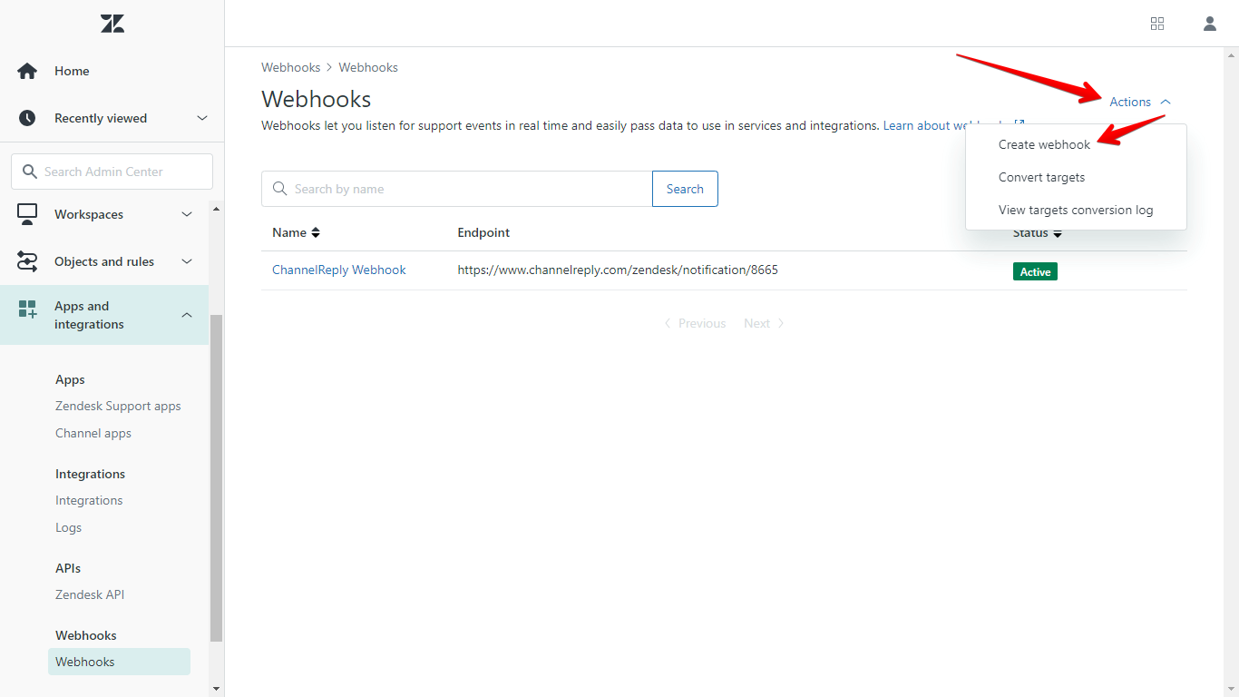

Click “Actions” in the upper right, then select “Create webhook.”
Actions menu and Create Webhook button

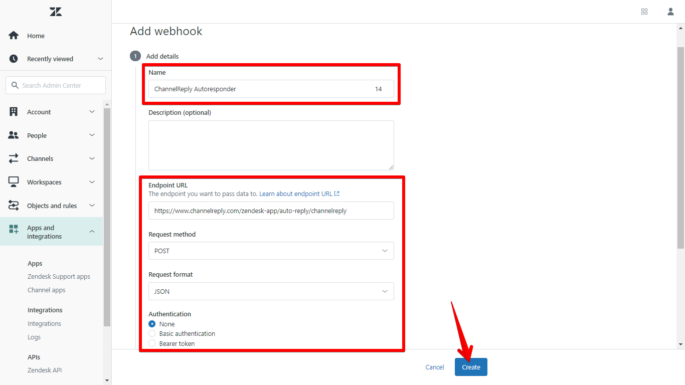

On the following page, name the webhook “ChannelReply Autoresponder.” Then enter the following data:
Endpoint URL: https://www.channelreply.com/zendesk-app/auto-reply/!!company!!
IMPORTANT: Change “!!company!!” in the URL to your company’s Zendesk domain. If your Zendesk domain URL were https://somebusiness.zendesk.com, you’d use the following: https://www.channelreply.com/zendesk-app/auto-reply/somebusiness
Request method: POST
Request format: JSON
Authentication: None
You don’t need to worry about other settings like Description. Once these fields are all filled in correctly, click “Create.”
ChannelReply's Walmart/Shopify/eBay/Amazon autoresponder webhook settings for Zendesk

Open the "Objects and rules" submenu on the left. Click "Triggers," then hit “Add trigger.”
Zendesk Objects and Rules submenu, Triggers menu item, and Add Trigger button

AS 3.1. Creating or Replacing Your JSON Code Automatically
You can create your JSON-encoded message automatically using our JSON converter. This tool is found in your ChannelReply account under Helpdesk Settings > AUTORESPONDER. It’s just below the autoresponder generator.
Simply type your message into the autoresponder message field. You can use Zendesk placeholders and ChannelReply custom fields in your reply.
Composing an auto-response in the JSON converter
Inserting an auto-reply into the JSON body field in Zendesk
You’re done! Any time you want to update your message, you can follow the same steps and copy over the fresh set of code.

AS 3.2. Creating and Editing Your JSON Code Manually
If you want to do this manually, copy and paste the following text into the “JSON body” field in Zendesk:
"ticket_id":"{{ticket.id}}",
"message":"YOUR_AUTORESPONDER_MESSAGE"
Replace YOUR_AUTORESPONDER_MESSAGE with your actual autoresponder message. Just be careful to keep the following in mind:
  • Write your message in a single line.
  • For each line break, enter “\n” without quotes or spaces around it. You will need two in a row if you want a blank line between paragraphs.
For example, say you wanted your message to look like the one below, with spacing between the lines:
Hi {{ticket.requester.first_name}},
Thanks for reaching out to us! We have received your message, and one of our agents will reply as soon as possible. We respond to all messages within one business day.
Cheerio!
In that case, your JSON text would need to be:
"message":"Hi {{ticket.requester.first_name}},\n\nThanks for reaching out to us! We have received your message, and one of our agents will reply as soon as possible. We respond to all messages within one business day.\n\nCheerio!"
Sample message in the JSON body field
Remember, you can include eBay, Amazon, Back Market, Walmart and Shopify data in your auto-reply! ChannelReply custom fields and normal Zendesk placeholders both work even in JSON code. You can instantly enter details like the item the customer bought, the status of their order and more. See our article on using custom fields as Zendesk placeholders for help.

AS 4.1. Auto-reply Once Per Ticket
Enter the following ALL conditions:
Amazon autoresponder conditions for replying to only the first message in every ticket
Finally, at the bottom of the page, click “Create.”
Create button on Zendesk triggers
Zendesk People submenu, End Users page, and Anybody Can Submit Tickets setting (enabled) in Admin Center
To check this setting on your custom fields, go to "Objects and rules" and click "Fields."
Zendesk Admin menu and Ticket Fields submenu
Open any field you need to check. You'll then see the "Required to submit a request" option, among many other settings.
"Required to submit a request" turned off on a Zendesk ticket field
Ecommerce autoresponder setup ANY conditions for replying to all messages on a ticket
Add the following ANY conditions:
Ecommerce autoresponder setup ALL conditions for replying to all messages on a ticket
Then scroll all the way down and click “Create.”

Next, clone the autoresponder. This clone will be used to answer messages you receive on existing tickets. To make the clone, mouse over your autoresponder, click the column of dots on the right, then click Clone.
Give the clone a new name, like “eBay Follow-Up Autoresponder.” Then change the ALL conditions to the following:
eBay autoresponder setup for replying to follow-up messages
You can edit the message (manually or automatically applying JSON code) if you want. Once you’re finished, scroll down and click “Create.”

Creating another autoresponder takes much less work. Just clone the trigger you’ve already created, then edit the clone. (Or, if you're using setup B, clone and edit both triggers you created earlier.)
  • Return to Admin > Triggers in Zendesk.
  • Mouse over your autoresponder.
