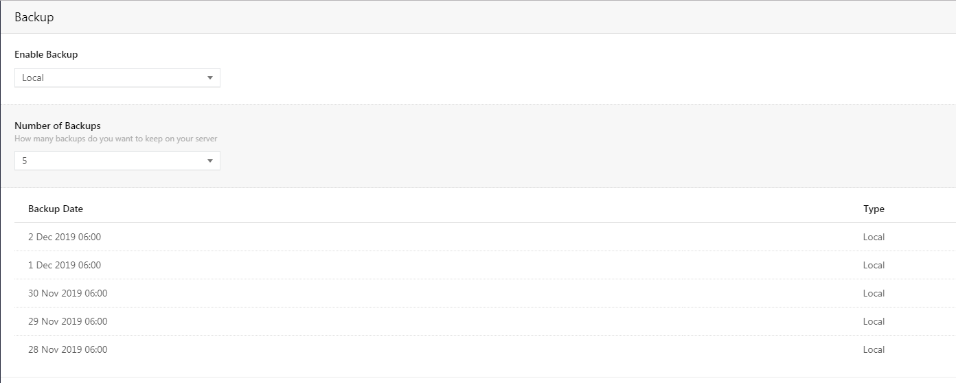

How long does a backup usually take? I manually made a backup vi the UI but the /work/backup directory does not update with a backup. There is another backup in the folder so it worked at some point. # of backups is set to 5. I removed the previous back and re-attempted to backup but nothing happened. Also, is there a log to verify the backup?
150
Hi Duane,
Let's organize a TeamViewer session to identify why backups are not created in your system.
Please let us know to support@useresponse.com if you are available for the session.
Regards,

141
Hi Lisa, My system/routers is not set up for team viewer and I prefer not to use that method because of security concerns. Instead, are there logs and where are they?
147
Hi Duane,
Please switch on errors displaying in configs/config.php, go to Administration - Backup, open XHR Network tab in the browser console, click Options at the bottom right of the Backup page, select Make Backup option and provide us server response from the browser console. Make sure to send the data to support@useresponse.com as now we are talking inside the public topic.
Please let us know if everything is clear.
