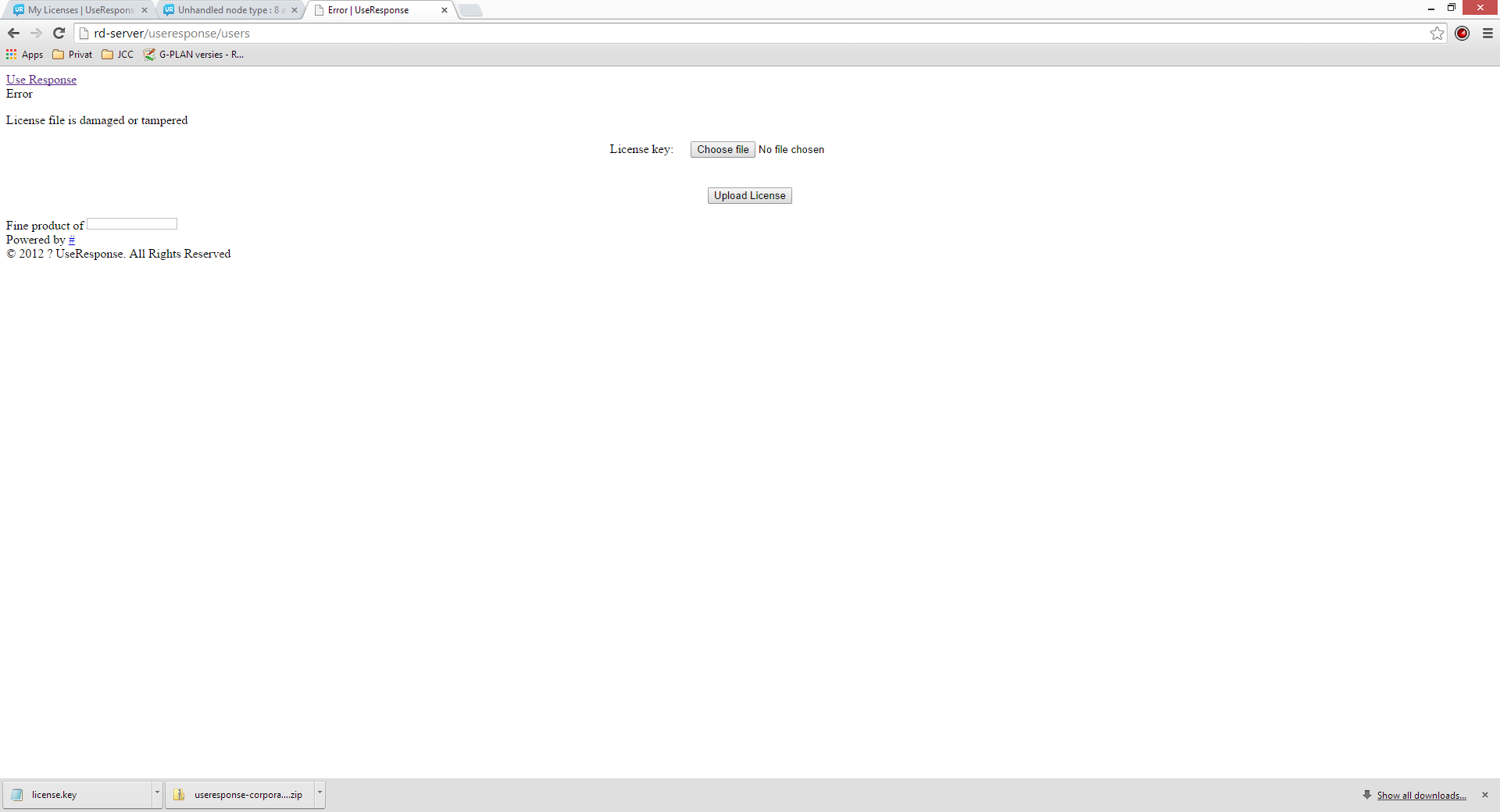

Sorry clean new installation but no success. Same problems. license file becomes 0 kb in application/config and no way to login in and by clicking right side op users see attached file.
