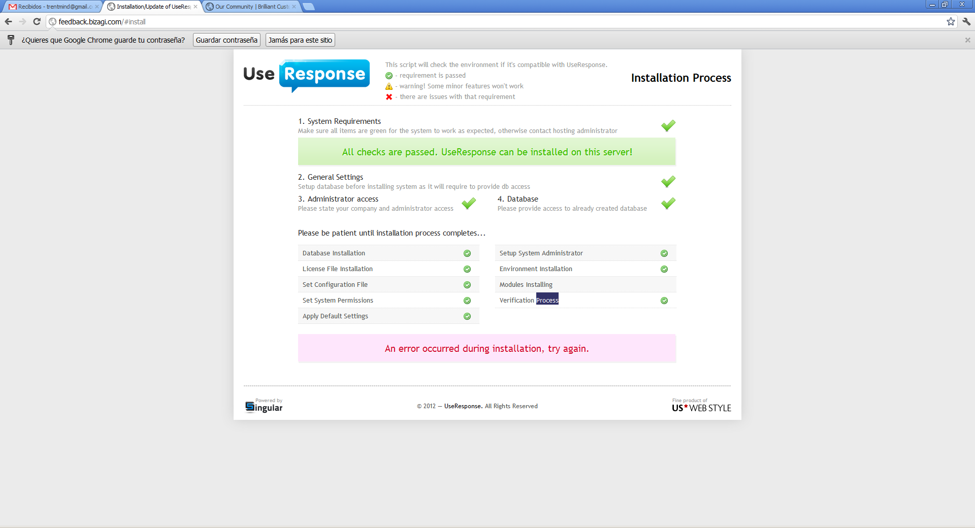

Hi,
there is an error message (please see the image below) in the last step of the installation of the product, but there is not a detailed information about this error. The environment that we are using for installing the product is:
  • Windows 2008
  • IIS 7.0
  • PHP 5.3.11 (fastcgi mode nts)
  • Mysql 5.5 server

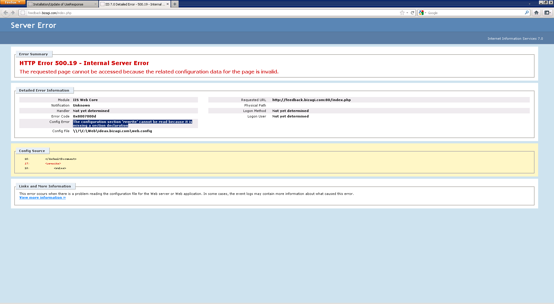

91
When I copy the file in the directory it generates the next error: "The configuration section 'rewrite' cannot be read because it is missing a section declaration."

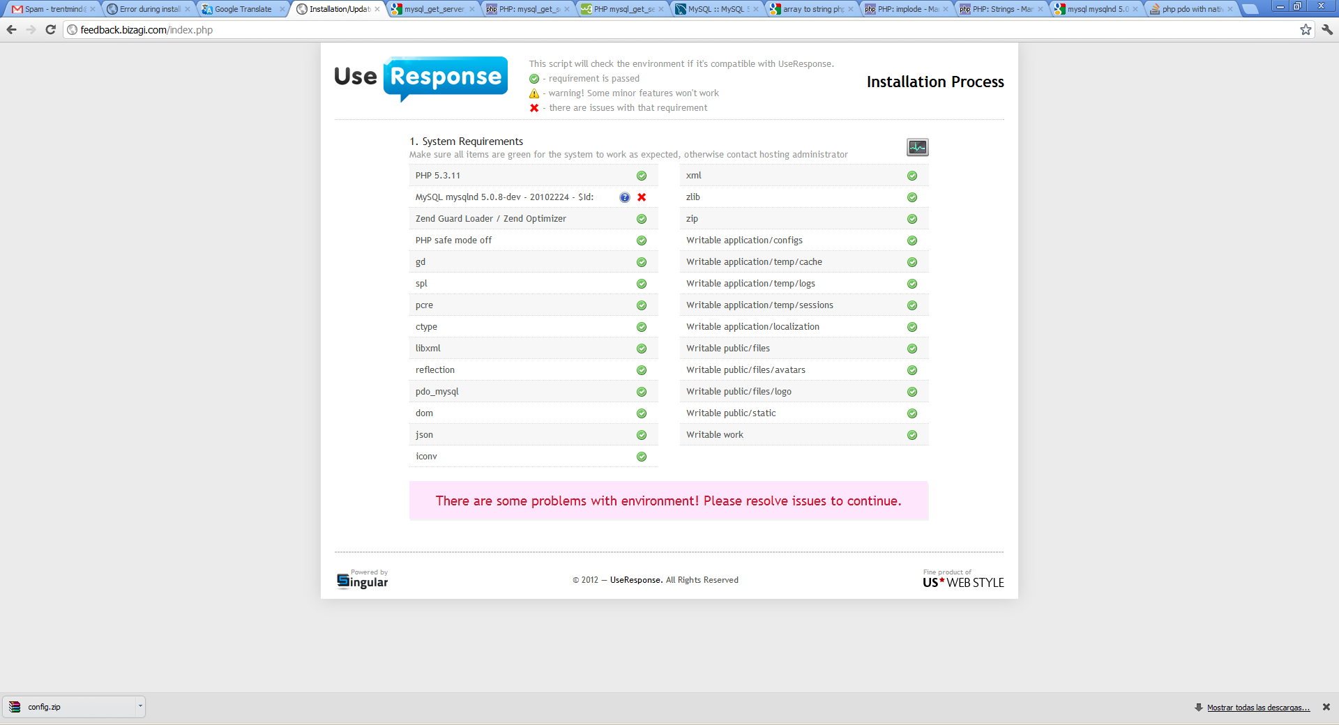

Now in the first step appears an error related with mysql (see the image). We use MySQL 5.5, is this version supported?
89
Yes, we had customers that installed UR with MYSQL 5.5 on board. As I can see from the provided screenshot, you have MYSQL 5.0.8 with weird built.
Could you please send ftp and db access to support(at)useresponse.com and we'll take a look at the problem and try to identify it?

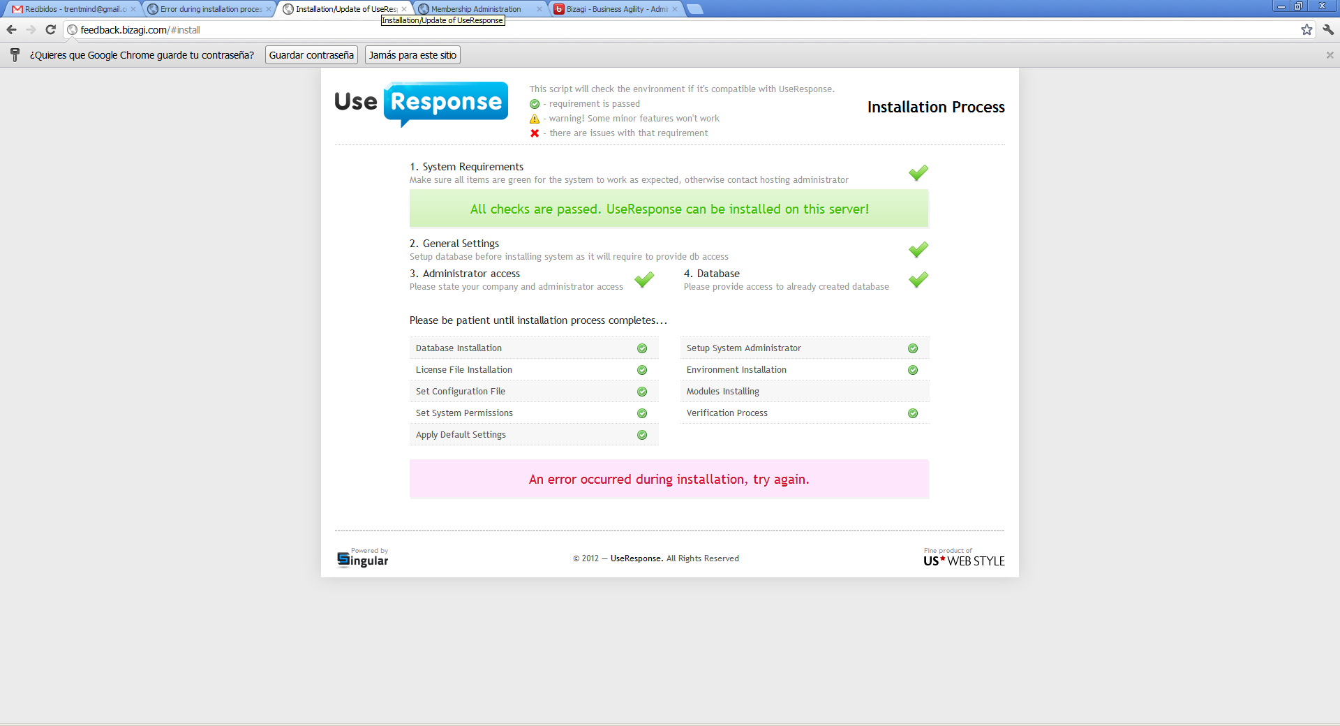

92
We have installed the URL Rewrite module and put the web.config file in the path, and I cannot see the first error message related to mysql, but while I am trying to finalize the installation, the same message is generated.
95
Looking through in more details. Update you when finished
