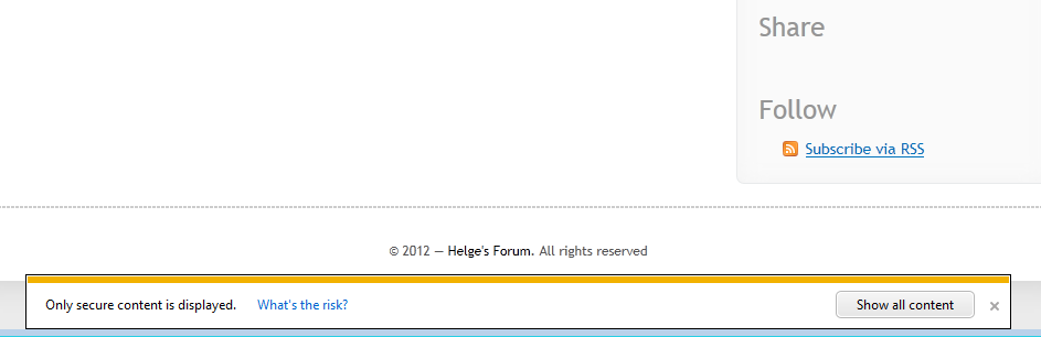

The "Tweet" button that is normally displayed next to the Facebook "Like" button on the start page is not displayed (I use HTTPS). This can be seen on the attached screen shot or at https://helgeklein.com/forum/.

This might be related to SSL and the browser used. The screen shot is from Chrome. Firefox displays both buttons (Twitter and Facebook), IE9 by default only shows "secure" content where neither two buttons are visible (see screen shot attached to this post).
