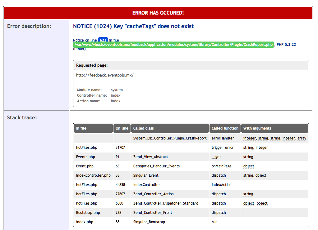

Hi,
After updating UR to 2.3 version, now appears this error in index file

Cesar,
Could you please clean /cache folder and let me know if it works?

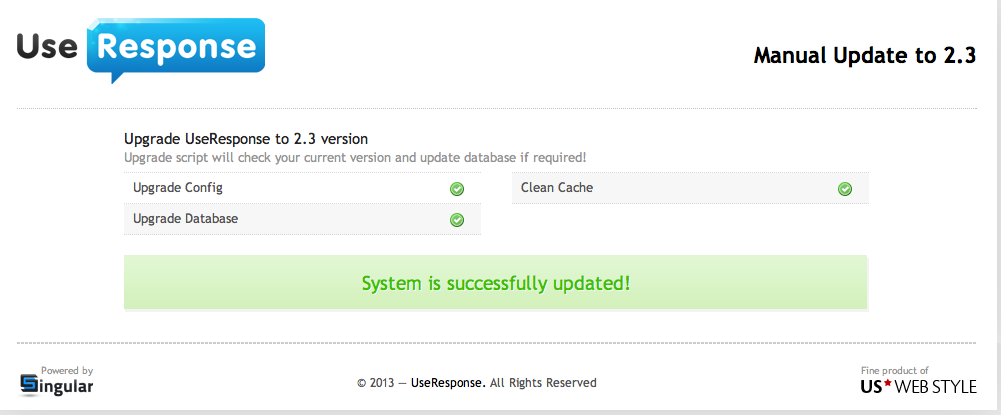

127
You should go to yourinstallation/upgrade in browser after you upload files. Use more details in our Announcement about the rest
135
I reuploaded UR again in Binary mode, I entered to /upgrade and appeared this message "System is succesfully updated", but I'm still with the same problem.
