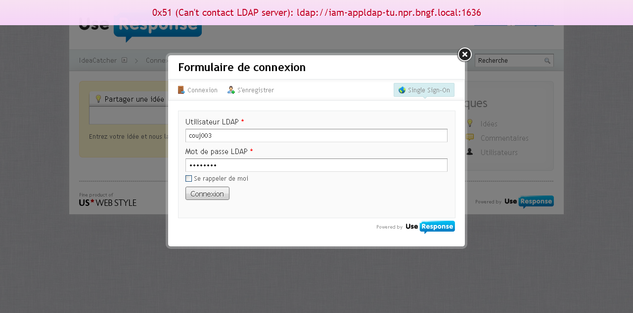

117
Attached picture is my current settings.
They have been provided by my LDAP team.
How can I test if the application can connect to the LDAP server?
Right now, when I try to connect, the error I get is :
Can't contact LDAP server (see other attached image)

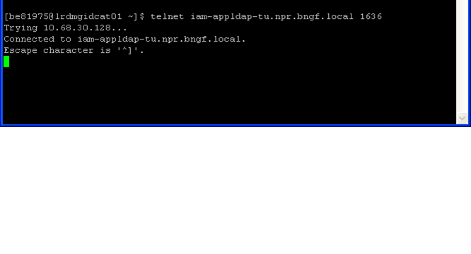

117
The connection is working between the 2 servers. (attached image is a telnet of the LDAP server from the application server)
What could be the reason of the error then?
113
After more investigation, it seems that you might only be supporting regular LDAP connection.
The connection I am using is LDAP S (securised connection).
Would there be a way to integrate LDAP S in the application?
108
Yes, we support only plain LDAP connection. We'll consider secured connection in 3.0 version. If you need custom development, please email us.
