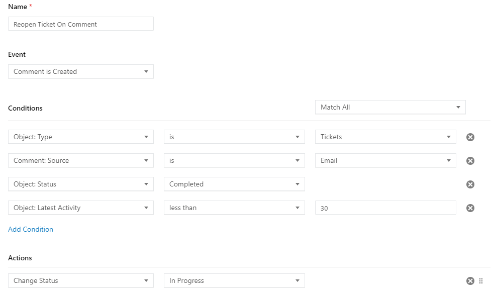

Is there a way to stop completed items from re-opening?
Answered David R. ● 8 years ago
We have tickets that are completed for months, and then the client decides to respond to the email chain which re-opens the tickets, and throws our stats out of whack.
Is there a way to stop tickets older than a certain period from being re-opened?
Thanks

Hello, David,
I guess the tickets are reopened automatically. Please check if the trigger "Reopen on Comment" is activated in your system. So you could deactivate it.
Look forward to hear from you.
153
Hello, David,
we improved automation rules in order not to reopen old tickets.
We added new condition "Object: Latest Activity" for "Comment is Created" event. Now your trigger "Reopen Ticket On Comment" could be built as shown in the screenshot attached.
It means that if user responds within the ticket with more than one month's activity, it won't be reopened.
The improvement will be available in the next release.
Please let us know if you need more clarification.

156
Hello, David,
please remove Comment: Body condition in the trigger and it should work.
You should keep in mind that custom email notification will be sent only if user leaves a comment via email.
Please let us know if it works for you.

158
Hi, David,
your purpose mentioned in the question above is to stop tickets older than a certain period from being re-opened.
As I mentioned in one of my previous comments, we improved automation rules in order not to reopen old tickets.
Once you upgrade to the latest version, you can use new condition "Object: Latest Activity" for "Comment is Created" event.
So you could edit the trigger which reopens tickets on comments in the way as shown in the screenshot attached.
It means that if user replies in the ticket which is not active for more than a month, the status won't be changed to "In Progress", it would stay as "Completed".
Please let me know if it's clear.

167
Hi, David,
if you want to test Object: Latest Activity condition, you don't have to wait for 2 weeks for example, just edit dates of comment's creation in your DB for test ticket and reply in the ticket as a user via email. So you could check how the trigger works.
I checked it again in our environment and it works as expected.
Could you please provide me the screenshot of your trigger? As for "Reopen on Comment" trigger you need to add "less than" condition and define the ticket's activity period when it becomes opened on new comment. If the activity is more than 14 days ago, so the trigger won't change status to opened, it stays completed.
If you don't want to reopen tickets and stay them completed, so it's better to deactivate the trigger.
Please let me know if everything is clear.
