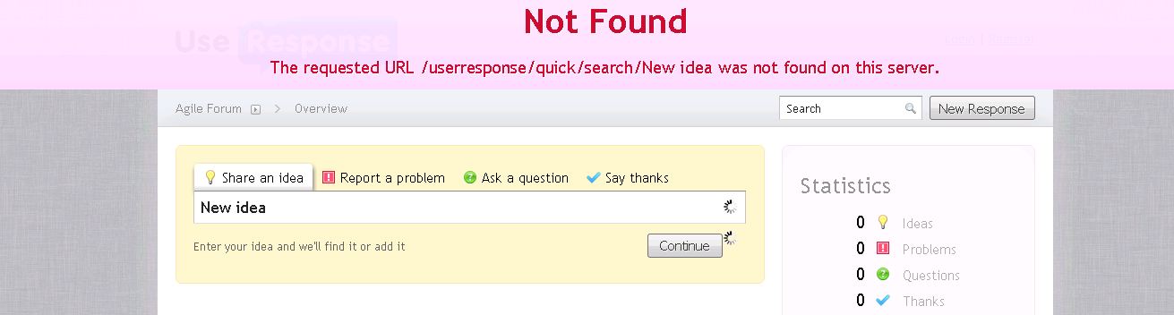

Hi, user response looks nice, trying to install the free version. First part about validation goes well (see screenshot), but when I click on "install", I got a 404 in response (see second screenshot). Any idea?

Thanks for the very quick answer. Just fixed that (that was indeed my apache config). I'm stuck one level further: install has been done, main page is showing under my domain localhost/userresponse (folder I put it in), but any attempt to use any functionality results in a page not found. I would suppose that this is something linked to my "base url" folder, but not sure which one.

You need to remove this line from .htaccess as you've installed in sub-folder of the domain (there was a hint on installation page about that):
  1. RewriteBase /

I did that, and restarted my apache service. Anything else needs to be done there ?
110
You can try also replacing this line in .htaccess
  1. RewriteBase /
with this line
  1. RewriteBase /folder
where folder is your installation folder that you enter in URL. In your case it's userresponse

I did the rewrite base without impact. Not sure my Apache is using the .htaccess properly, will need to check. Could you share a standard htaccess file for user response?

Ok, I understand. Looks to be working now, so thanks for your help.
