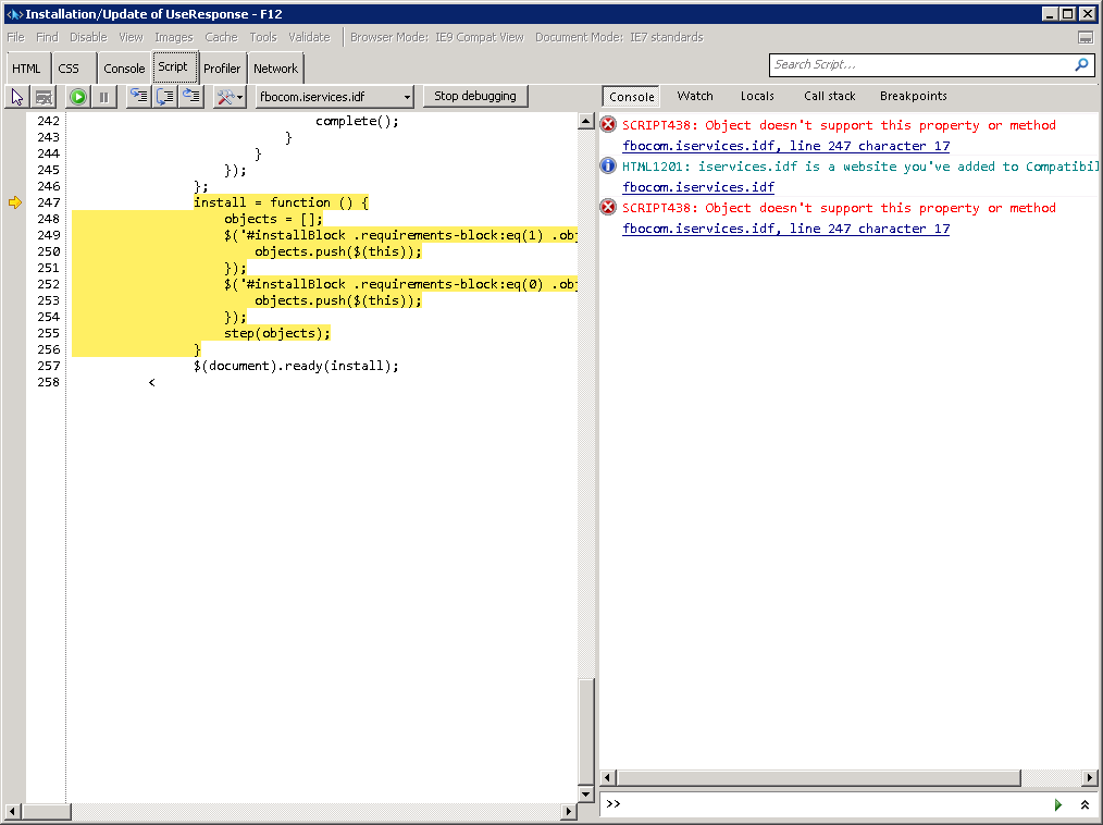

136
Hello, and thanks for the fast response ;)
maybe the picture is saying more about the issue,
the web.conf with the urlrewriting from here is loaded.Thomas

Thomas,
Try to install UseResponse using Firefox browser (with FireBug extension) or Google Chrome. IE doesn't provide extended information in debug console. You need to catch XmlHttpRequests (Ajax) calls and see what response returns.
Please provide us both data returned by last request and response to see what kind of error has occured.

124
The problem was in IE7, according to provided screenshot, as we support IE8+
