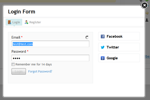

This is probably the easiest way to reproduce it:
  1. Go to http://helgeklein.com/forum/
  2. Click on "Login"
  3. Enter E-Mail "test@test.com"
  4. Enter Password "asdf"
  5. Click on "Login" button
That gives me an endlessly spinning wheel (see attachment).
132
Helge,
The thing is that you are trying to use https requests on http domain. As I understand, you use community on https, so in application/configs/application.inc you should have baseurl to be https://domainname.com/forum
But if you go to http, no requests will pass.
So you either use http or https. Just put 302 redirect rule in .htaccess located in installation folder of UseResponse. Let me know if it works for you
