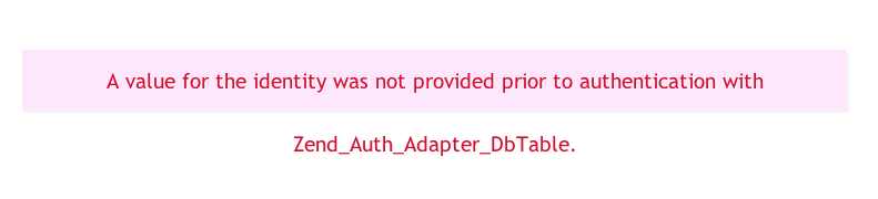

We are receiving this error when trying to connect to Facebook:
A value for the identity was not provided prior to authentication with Zend_Auth_Adapter_DbTable.

Eduardo,
Do you experience that problem only with Facebook Login? BTW, default keys are set for UseResponse applications, so if you try to insert custom keys, make sure to follow instructions in Admin Manual
Also, your environment requires internet connection to not be blocked (outgoing traffic) as authentication process of social logins goes with the help of our server until you set up custom applications in Login Plus Settings.

Stas Kuzma wrote:
[p]Eduardo,
Also, your environment requires internet connection to not be blocked (outgoing traffic) as authentication process of social logins goes with the help of our server until you set up custom applications in Login Plus Settings.[/p]
It's happening only with FB. Twitter and Google are working fine. On our other server, it was working, maybe it's the outgoing config.
128
BTW, tried with the default keys and got the same error message.
122
I double checked the configurations on my host, and the php variable "allow_url_fopen" was set to off, just fixed that and the FB login is working like a charm. The process of enabling the loginplus module should check if the server is allowed to perform outgoing connections to make it easier to debug.

Stas,
the problem was with the outgoing config. After changing it, the FB logins started working fine.
Thanks for the support!
122
Thanks for the feedback and solution! We'll put a check on Login Plus installation process to check if "allow_url_fopen" is set to yes.
Update: Fixed in 1.0.2
131
Eduardo,
We've improved Facebook login to not require the parameter, so even if it switched off, FB login will work
