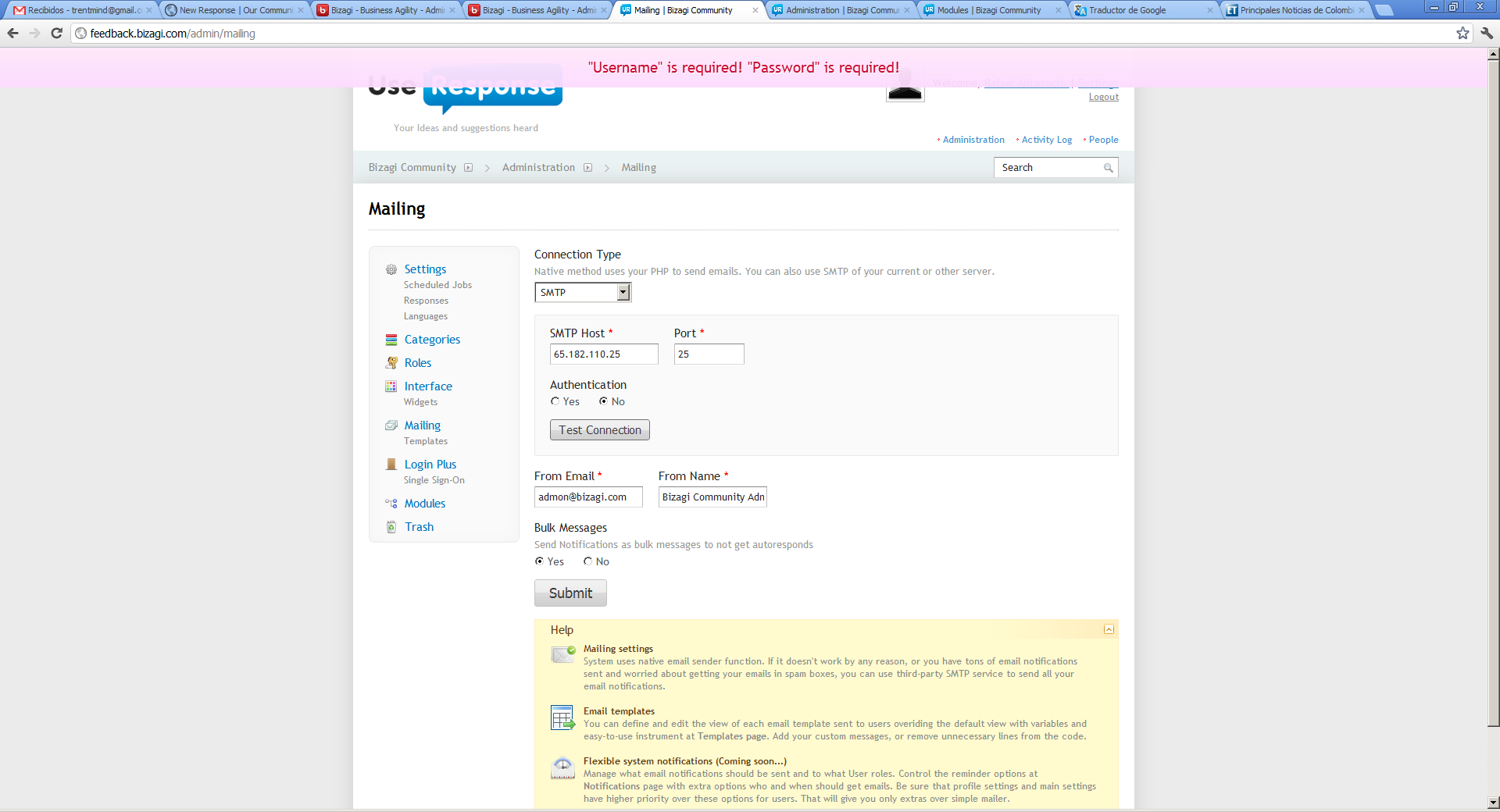

Hi,
When I try to setup a SMTP server without authentication, the application validates the field of username and password.
Thanks in advance,
Rafael
Best Answer
Thank you for reporting this problem. It's now fixed, see comment below. This fix will be incorporated into next release.

Please replace original file at application/modules/resources/forms/Mailing.php with the one, from archive attached.
93

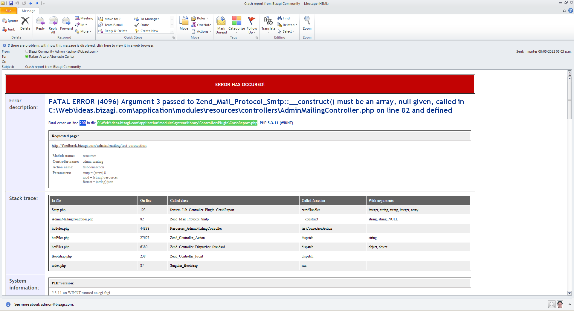

When I try to test the connection with our SMTP parameters, we receive an email with a Crash report (Thanks in advance). Is this normal??
107
To fix it, please replace AdminMailingController.php in /application/modules/resources/controllers with attached file (extract preliminary)
This fix will be incorporate in the next release.
