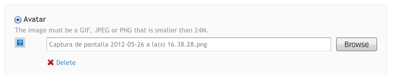

When you upload a file with a large name or spaces or like this: "Captura de pantalla 2012-05-25 a la(s) 13.31.19.png", no display Avatar

The problem is fixed and will be incorporated into the next version of UR.
You can fix it now in your system by going to PHPMYAdmin or any other db manager and in users table change photo field from varchar (37) to varchar(255)
