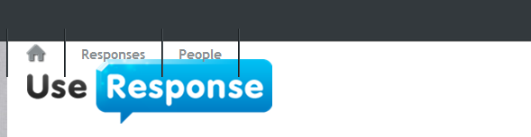

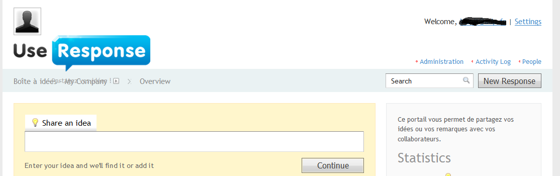

Hi,
The application is working great on Google Chrome but it seem to have a lot of bugs within Internet Explorer 8.
First of all I have issues with the Default Theme and the css. Some blocks are not displayed correctly (See the example in attachment).
And furthermore it seem to have a lot of bug with the menus and button. Probably with the Ajax, some button don't work (The browse button for the community logo for example, or also for example I can't switch language from IE)

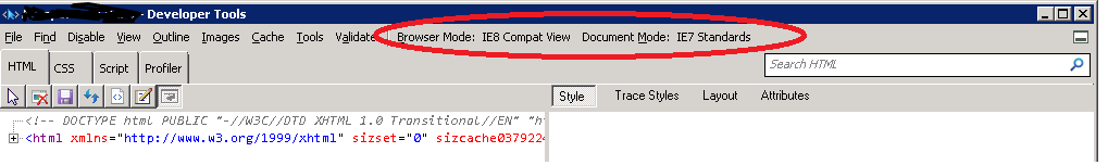

133
Ok I found the problem.
By default IE execute application in an "Intranet mode" if the webserver is on a local network.
It runs the page with a "Browser Mode :IE8 Compat View" and a "Document Mode: IE7 Standards" (see attachment)
I fixed the issue by forcing the "internet mode" with the application. I added thoses line in the web.config :
  1. <httpProtocol>
  2. <customHeaders>
  3. <clear />
  4. <add name="X-UA-Compatible" value="IE=edge" />
  5. </customHeaders>
  6. </httpProtocol>
Now it's work.
I still have some css issues though, but I should be able to fix that.
Thanks you.

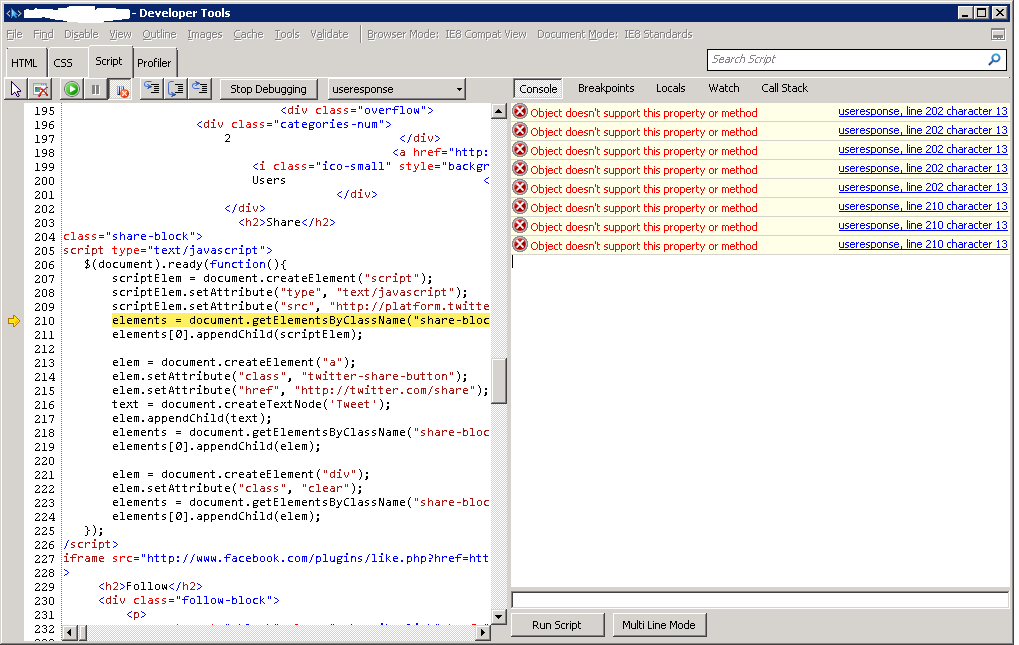

134
There is bugs with the javascript on IE8.
This line doesn't work:
  1. elements = document.getElementsByClassName("share-block");
"getElementsByClassName" is not supported by IE8
162
Niborg,
Could you attach a screen with error information such as file and line number to be able us to fix it in next version.

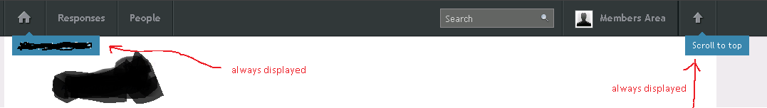

133
For the bug with the getElementsByClassName it seem to be in the javascript for the "share" functions (see file1).
Also, I have a bug with the "title" of Home and Top as you can see in the second screen shot. They act like if they were always "on hover"
137
Thank you for this report. We will fix it in next release.
